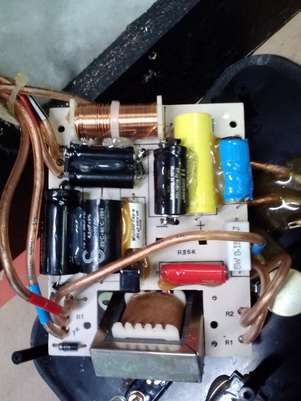

Here are a couple pics of the finished Kappa 6s and the crossover with the new NPE installed. Tried to post these earlier but just now had time to figure it out.
For the parts, did you use the reference sheet on Infinity classics or did you take the numbers off the existing caps? If the latter, how much did they differ from the reference?
Here's a previous thread with the values from the reference sheet.
I initially got a copy of the Tech sheet off infinity-classics.de. After reading several post about production changes I decided to confirm the values before I ordered the caps. The crossover as built matched the tech sheet. I am going to make an educated guess that the tech sheets from Infinity(at least in this case) may be final revisions based on the fact that I found a date sticker on the large woofer induction coil with Sept 1991.
