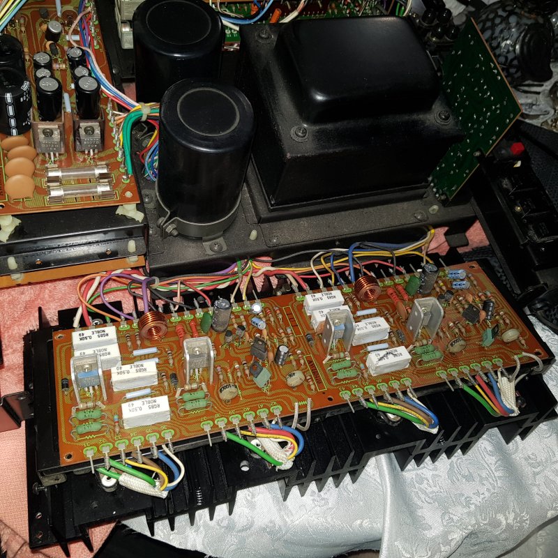

I hit a snag on my first board today, the power amp board. It seems I did not order KSA940TU transistors for the 2SB536's. So that tells me that it was not on the BOM I copied. Looking at the sub lists, only the 940TU is listed for the 2SB536. Is there anything else I can use? MJE1503xG? I have the 32, 33 and 34G listed for the 2SA816 and also listed the KSA940TU later on.
I cannot find the BOM I used from this site to see what they had listed. I was so happy to finally start this thing today, wanted to get the power amp out of the way first because it is the most annoying part to get to. I am dying to get the board back where it belongs but while I have no transistors to install, I don't want to do that.
Damn, the solder on some of the boards is TOUGH! I always have my desoldering station set to 300 which has always worked perfectly, melting and sucking in 2 or 3 seconds. The solder on the power board though, man, it just refuses to melt.
I am picking up some parrot clips for my DMM today, so I will also grab some desolder braid. I will have to do it the old way and be EXTREMELY careful. I am determined to get through this "ordeal" with no damaged pads. Apart from the control amp, grrrr.
The power board is also a tad scary because every goddamned pin is bent and against the board. The two legs I managed to suck the solder from, I also straightened up as I usually do but the problen is that the legs pulled lacquer off the board where they were laying. Arrrgh, slow and careful is how I shall go! I did put the transistors in the power board and that was it. Went to the tone board after that which was much better! Except for the two larger caps. They had the terrible non-melting solder and were of course, bent against the damn board. So they will have to be desolder braided as well. Wish me luck, guys! I want my amp singing tomorrow!

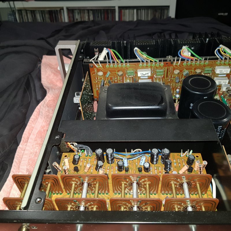

Oh one other thing, any tips on managing the protection board? Does the whole side have to be removed so the board can be pulled down flat? Or will taking the wires out of the holders give enough slack?
Same with the phono board. Do the black metal parts have to be removed to get to the board or do people usually just desolder from the bottom with everything intact? The phono transistors are of course, under a part of the metal. It looks like I may be able to get them in there with some pliers and patience, but I don't want the control amp disaster to happen again!

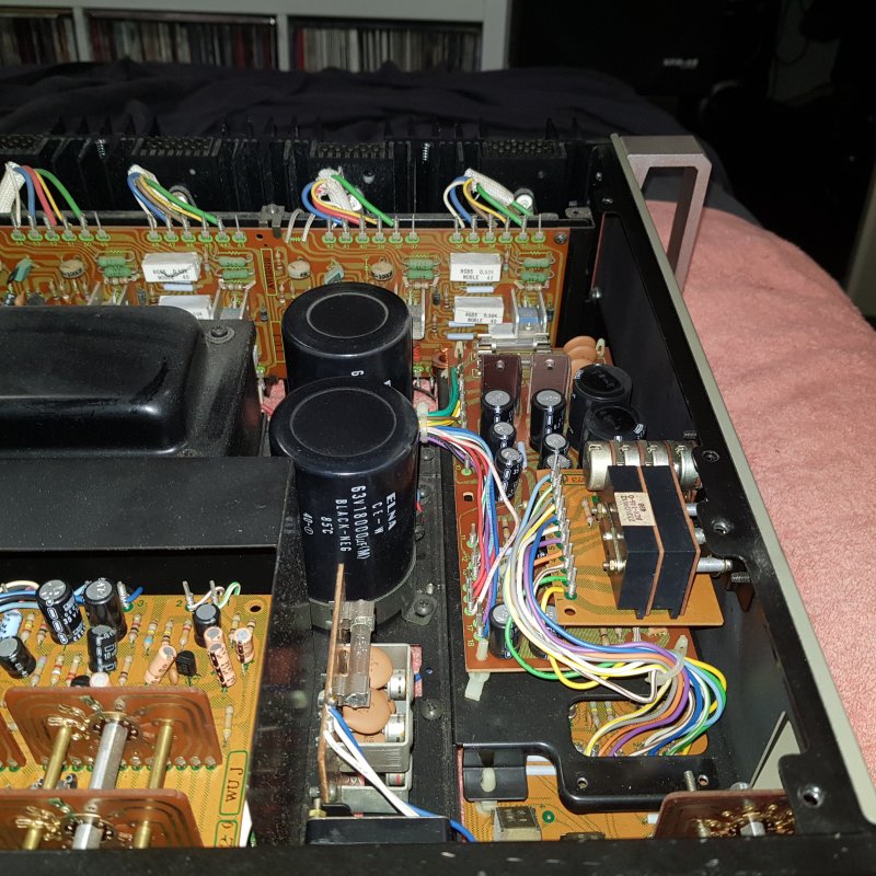

Well..... finally finished the board a little while ago anf tested it out. It popped the 6a fuse underneath the board. I hope someone is reading this as I could use some help :D
My first thought was the dodgy control board connections, but I just now though about the outputs. I put the outputs from my AU-9900 and put them in the SA-9500. If one or more of the outputs are fooked, could that blow the fuse? It is possible that the Sansui screwed tye new outputs. I do not want to put the old ones back in before I know it is safe. Thankfully the fuse did its job and seems to have stopped any further damage.
So, fooked outputs or dodgy connections on the control board? Or something else entirely? There were no lifted pads on any other board and I checked each transistor at least 5 times. But, could it be something on a power board? Where should I start with this?
Any help is GREATLY appreciated!!!

Another theory, I changed VR1-4 on the power amp board. I just read a thread about main fuse popping. It turned out to the voltage set too high on the VRs. I was positive I turned them counter-clockwise but I guess it is possible that I was looking upside down....? Hmmmmmm.....
Hehe, thanks :D
Are you using a dim bulb for testing? If not and the trimmers are fully on, that could have blown outputs??
I don't have my dim bulb tester at the moment, which I know is bad! But I was confident that all would be okay.
I did check the trimmers and the two with finite movement are turned fully counter clockwise. This is looking at them front on, and up the right way.
I am really thinking that one or more outputs were blown before I turned the amp on. That would blow the fuse, correct?

Get a bulb inline.... It will save you fuses, outputs! Check your output transistors.
