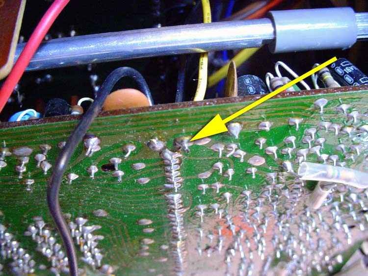

Picture = 1000 words
Just happen to have one laying about ...
Sorry ... ain't about to pull the board so you can see the markings ...

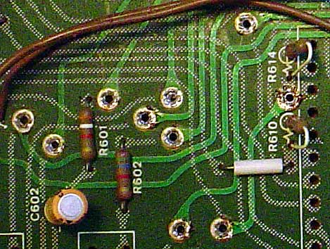

Problem is, the pass through holes have thin rivets in them. Those were pressed in, then soldered, so the actual connection surface is mighty small - just a poor design. Factory had the advantage of new stuff and that's the only reason it took 30 years for these to fail. You can see the rivets in this pic:
What happens is, the solder breaks and the connection goes intermittent. Problem is, new solder won't flow properly under the rivets to get a reliable connection, what with 30+ years of oxidation to contend with. New solder on top looks pretty, but it can't get a "grip" as the copper traces are sealed as well. Basically, you're just throwing a bandaid over the top, even if you DO take the time to desolder and clean each joint. And, if you're gonna do that, might as well throw in a pin, right?

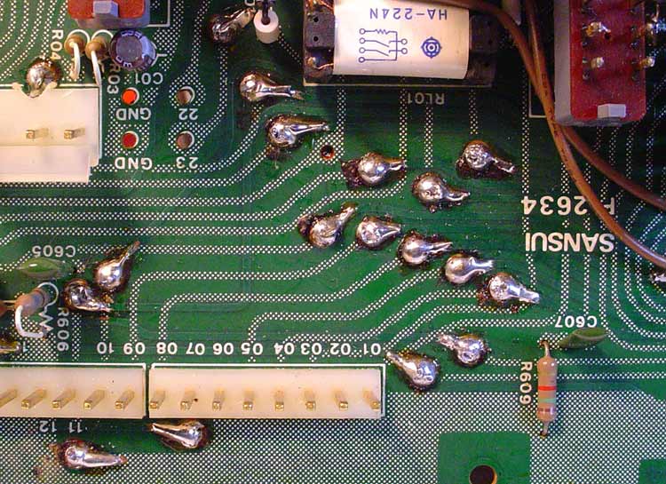

OK ... one more scary pic, and I promise no more ... <G>
Here's what all it took to get to the dolby board on my 9001 ...
