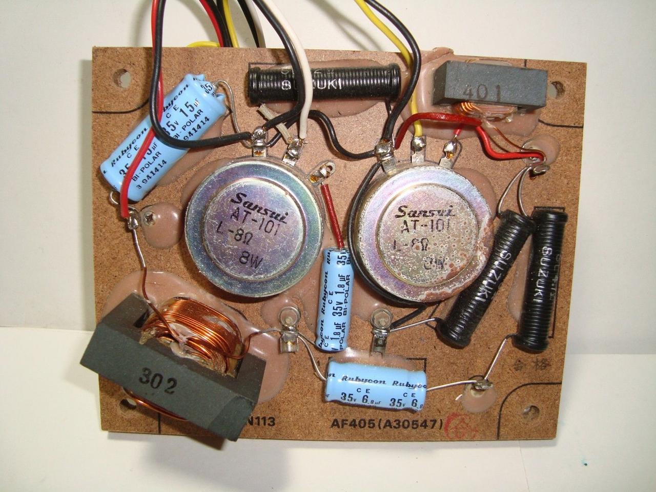

I'm gonna say that those caps needed replacing based on this AS-200 crossover that I found on sale at eBay. There is no goop showing at all.
I didn't buy it, just copied the pics for reference)

I recently recapped my AS-200's. Here's the crossover before & after:
The biggest problem was removing the old caps. You just have to grab them with pliers and wiggle firmly to break them loose from the glue. Usually the blue plastic will come off the cap as you remove it. Also, the positioning of the new caps is a bit tricky, since the replacements are much bigger. It just gets semi-difficult to solder in tight spaces.

There was definitely some improvement. I felt like with the old caps, they didn’t have much clarity. The overall sound filled out and sounds much more natural than before. Get an inexpensive solder station and practice on some scrap wire. There are many videos available with pointers on how to solder. The biggest mistake novices make is melting the solder onto the wires. You have to heat the wires with the tip of the iron, then the solder will flow along the connection. If you live near Northern Illinois, I’d be glad to help you do a recap. Good luck.
That AS-200 crossover looks far better than the other one, having a filter on the woofer. Thanks for this thread, makes me know what model to look out for!
Don’t be fooled by a more sophisticated crossover. The AS-100’s are a great sounding little two-way with solid cabinet construction and quality drivers. They definitely punch above their weight!

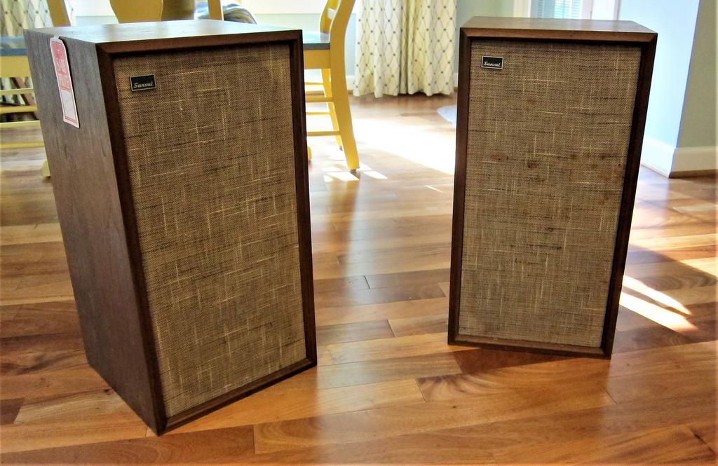

The good news is that I think my bone stock original AS-200's sound great!
Here they are the day I brought them home from the thrift shop last Fall. The $10.00 price tag still taped to the side.
