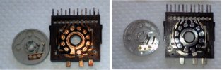

Very new to Hifi, please excuse my lack of knowledge.
I live in Japan, and recently purchased a used SANSUI AU - α 507R. It worked well at first, but recently it has started to intermittently output sound from only one channel (typically right, but ocassionally only left). Ocassionally, it will output from both channels, but after a few minutes one channel will cut out.
I have tried swapping the LR input cables to verify that the issue is not the turntable, but the input seems to be fine.
Steps taken to try to fix the problem:
  • Applied Deoxit to all the controls I could easily access (including source control, volume, and balance, among others)
  • Applied Deoxit to the input ports
  • Replaced the relay
  • Tried to clean off some firty flux from the easily accessible PCBs
Immediately after replacing the relay, it did output sound from both channels, but the problems returned a few days later.
Sometimes after unplugging the input and plugging it back in, a loud buzz will play, then the channel will return, but it will usually cut out again within 3-10 minutes.
Any help would be greatly appreciated.

This could be a lot of things, oxidised switch contacts, or connectors, but also possible to be dry joint(s) or faulty semiconductors. I have never seen the schematic for one of these, but the unit looks very nice with a classic Sansui look about it.
If you are a novice to electronics, this isn't going to be an easy fault to find, and suggestions for other Sansui amplifiers to buy may just place you in the same position but with a different fault. After ~30 years often a lot of TLC needs to be applied to such units, and experts in vintage HiFi are getting more difficult to find.

Well, a re-cap should make it sound better, but re-capping should not/never be considered as being a fault finding technique. It's hard for me to know how much people would charge in Japan for such work, but I'll guess about $500 +parts (about $100?), if done properly. The more I think about the fault you have described the more I think it is a cracked or dry solder joint somewhere. It is such a shame that even in Japan, people won't work on such equipment, or outrageously over charge for various reasons.

@tea station
Service manual is available, if you have account or know somebody who has one: https://www.hifiengine.com/manual_library/sansui/au-a507r.shtml
Unfortunately is too big to be attached, but at least you can see the schematic attached below.
There is a motorized rotary input switch in your amp. Without knowing the exact type, all I can say is that those used by Pioneer and Onkyo amps are notorious for going oxidized over the years and making exactly those kind of symptoms - either lower volume on one channel versus the other, or cutting it entirely.
In case of those used by Pioneer and Onkyo amps, the only long-term solution is to get them out from the board, dismantle and clean carefully, then put them back. Any deoxit spray or similar will not reach the contacts are as they are "covered" internally. Being there, done that. You can also see how the contacts look before and after the cleaning.
Again - this depends on the exact type of rotary switch used. If the one in the Sansui looks like what you see in the below pictures, then from my point of view cleaning is an absolute must. Be very careful with those gears, they go brittle as the years pass-by. And even if the input rotary switch is a different model, I would still clean it as the first step - just to eliminate that potential problem from the list.
