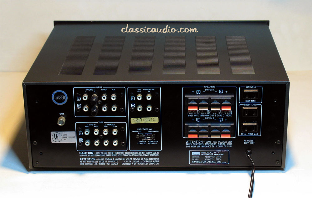

If you have a couple of RCA phono cables you could try setting the amp to 'separated' and use the RCA cables to jumper the connections between 'pre-amp out' and 'power amp in'. Try this with 'right' to 'right' & 'left' to 'left' first - your results should be the same - no left channel. Now swap them, 'right' going to 'left' & 'left' going to 'right' - probably ok to leave the amp on while you do this but make SURE you have the volume at zero before each switch move or cable move.
If the 'good channel' changes sides then there is something amiss in the left channel pre-amp, if it doesn't change, the left power amp has a problem of some kind, (could still be the speaker relay).

Hey John- That's not what I see. It's a 3-position switch...There's a "Connected" position, and (2) "Separated" positions—"Direct Coupled" and "Capacitor Coupled". (Both of the coupled positions are fall under the "Separated" category). See photo
Sorry, you are correct - either of the separated positions is fine, of the two - chose 'capacitor coupled' for now. ;)
