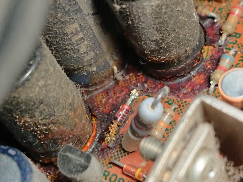

Hi Guys,
Thanks a lot for your replies!
Makes a lot of sense starting with the repair first before the restoration.. but in this case it seems the glue did some damage already as seen on this diode:
Unfortunately this is not the only component affected, there is actually 2 more diodes fully covered in this kind of oxide/corrosion plus several other diodes and several resistors, basically everything close to the caps is affected, in addition the C605 is leaking...
I guess I should replace at least the affected corrosion affected components before measuring anything, does it makes sense?

Looks like the power supply board might need a rebuild first !!
Yeap - now I see it, that doesn't look good, in which case you will be forced to rebuild that board (only). Hoping that doing so flushes out the problems noticed, so you can test functionality before you proceed. ;)
yep, would definatly remove the glue, and replace those parts oxidized by the glue. the glue is partially conductive as it ages....
do that first then go from there.
Hi All, thanks a lot for your hints, I started yesterday counting the components affected so the result = 39, including diodes, resistors, caps and 1 transistor (TR10=2SC1708 as schematics and C170882F printed in the component, I need to find out whether it's still available and the correct model number!)
So the adventure is just starting!, I will go ahead and try to do the corresponding upgrades shown in Leestereo's post

I could finally restored/revived the board F-2663 and now looks awesome, witout this corrosive glue, in addition I did the measurments shown in Leestereo's post:
