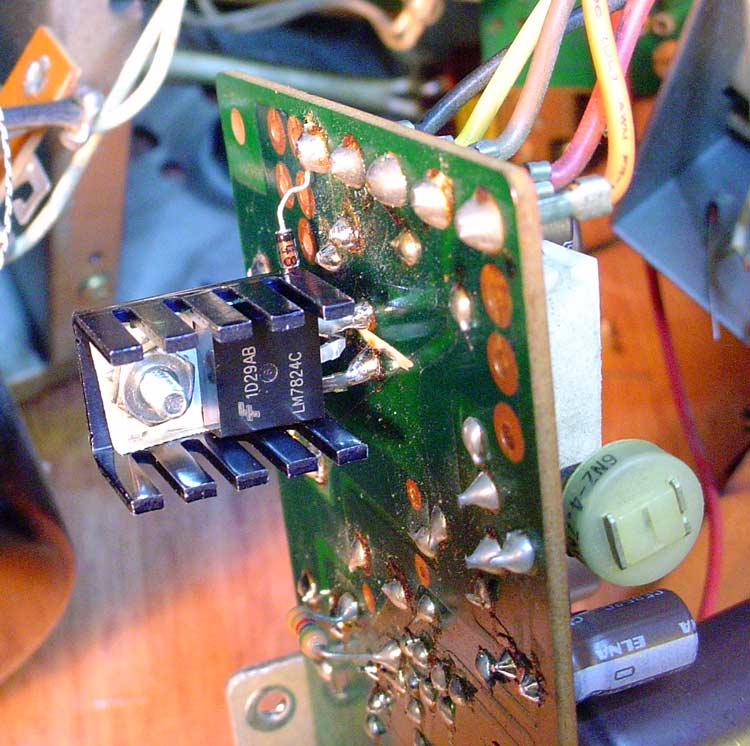

I highly recommend adding a 25v regulator to the decoder chips power circuit. Instructions are available at QRXRestore, along with some other tasty tidbits, including complete alignment procedures. Here's mine ...
Be extremely careful making voltage adjustments, as those are tweaky, and the slightest nudge can do serious damage to unobtanium chips.
