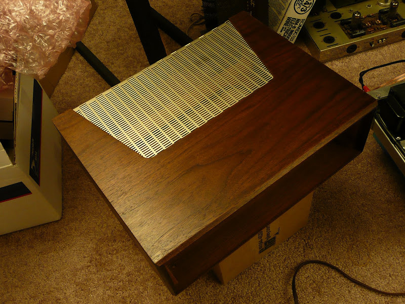

How do you guys clean up your Scott wood cases? My half-assed attempt with steel wool and Restore-a-Finish didn't get me as far as I hope it would've. Then again, I may just build a new case for this one...
Expect updates in a few weeks, possibly with all the lightbulbs loaded into this puppy :)
I used a scuff-pad, maybe some 600 grit sandpaper. The veneer isn't too thick so don't rub too hard. Afterwards, I cleaned it off with a damp cloth to remove dust. Let dry, then I applied some Walnut flavored minwax varnish. This will also hide the light-colored nicks where the veneer was chipped off. After that dried, I used some semi-gloss spray urethane.
I strip the old finish with stripper and a putty knife. Then it's lots of steel wool and sandpaper. Two coats of sanding sealer and 2 coats of polyurethane (both brushed on) with very light sanding and a tack cloth to pick up dust in between coats. Finally a coat of paste wax. It would be hard to break me of this routine- it's been very effective on many a refinishing job.
