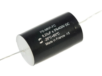

Thanks, but I'm just looking to replace the capacitors on the crossover. A guy in Australia recently rebuilt his crossovers, using 8.2 uf 250v film capacitors. I'm currently considering:
Dayton Audio 8.2mfd 250v 1% Metallized Polypropylene Caps, 0.0007ohms DF, 22mm D x 46mm L. 8.2uf​
I ended up ordering these....

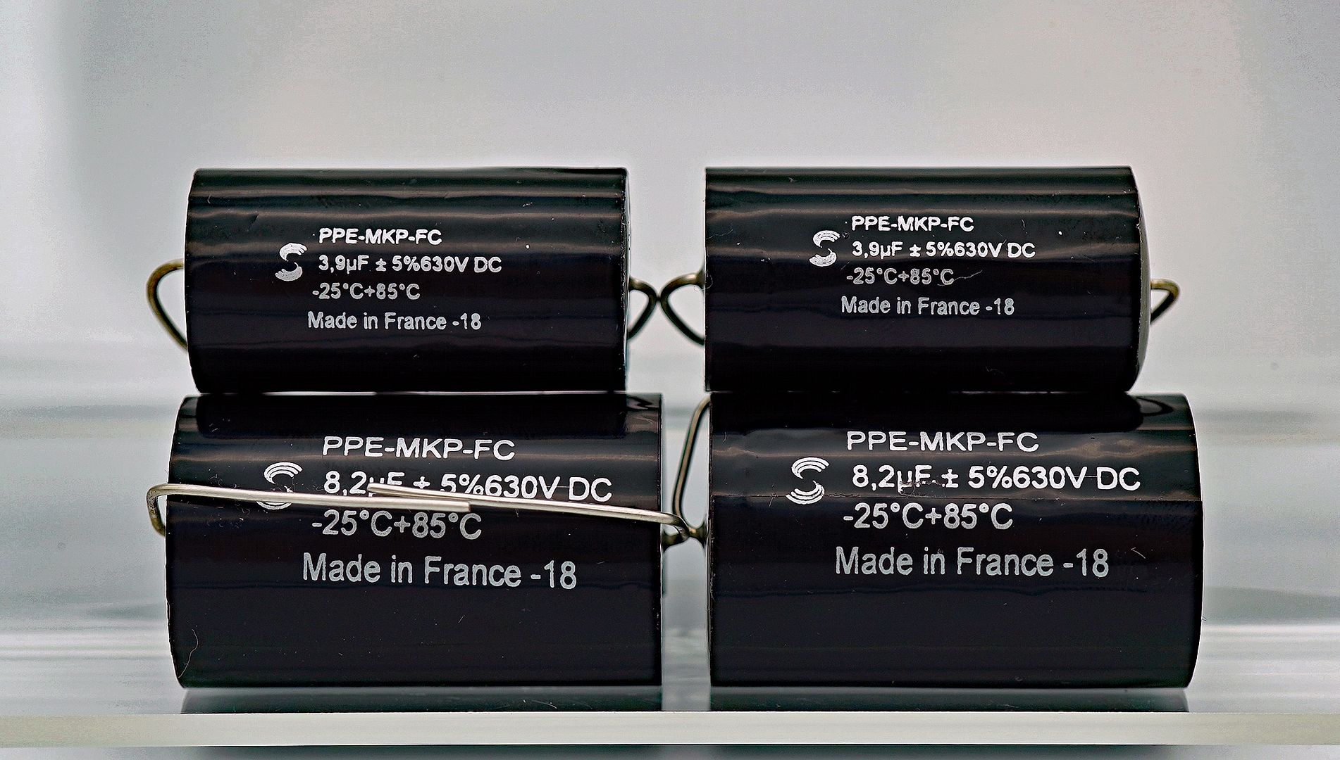

I've used those Solens before. I like them. I used the PPE version not the PB.

Finished the rebuild on the AL Model 3 Series II (new caps, deox of treble pots). Now hooked up to my Marantz 2270 and they sound fantastic. Major improvement in the higher frequencies, more definition, yet still warm and easy on the ears. Very pleased!
