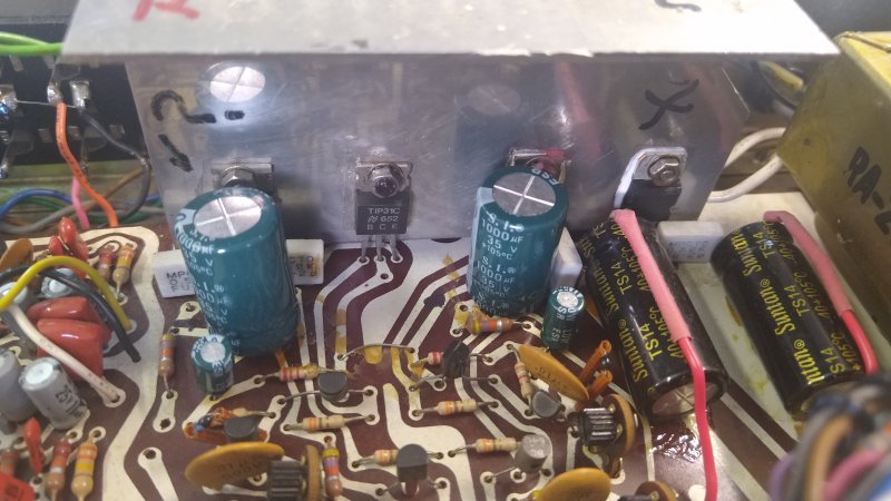

I should add that the Rotel was recapped about three years ago but by a different tech from the guy who did my Sansui and I suspect rather ordinary parts were used.
Also it is making a horrible loud crackling through the speakers in the few seconds after it's switched off, and has been taken out of service at the moment because of that. So if anyone has a suggestion of what to check or change there, that would be helpful.

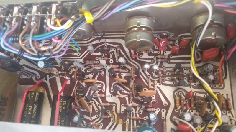

The Rotel RA-210 appears to be a relatively simple capacitor-coupled design and it's likely that many of the AU-555A upgrades/modifications can be adapted for it. Do you have pictures of the interior of the RA-210 that you can post and/or a list of work done during the recap?

Multiple angles to allow identification of the replacement components and pictures of the solder side (if any components were added there).

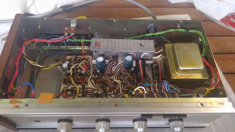

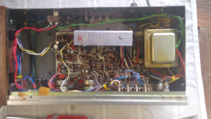

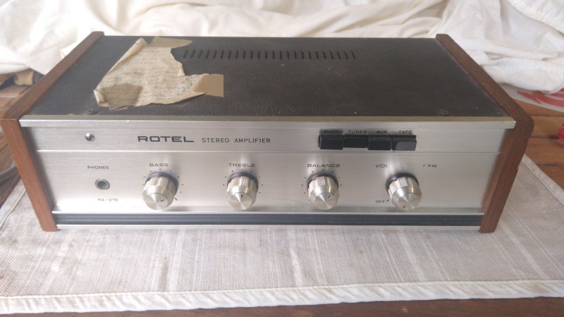

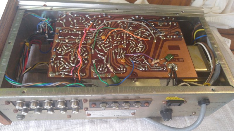

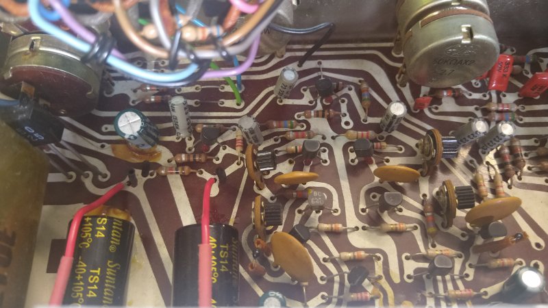

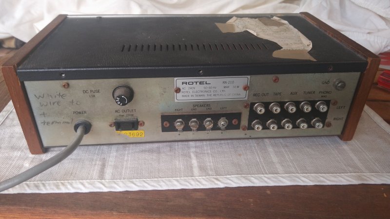

Ok, I eventually got around to lifting the top and bottom lids on the little old Rotel to take some pictures as suggested months ago. Not sure if these will help prompt anyone with suggestions, but here they are. First time loading media here so forgive me if I'm doing this wrongly... Please excuse my amateur work with a low-quality smartphone...
Thanks and cheers, Rob

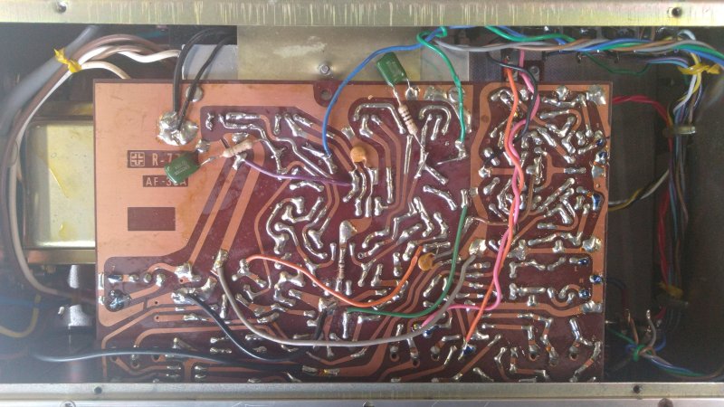

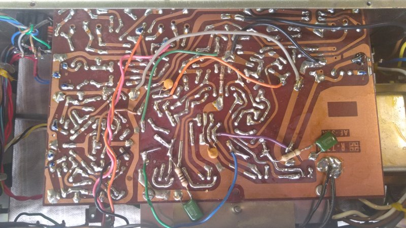

Please refer to pics just loaded. I hope they are useful. The solder as seen from underside seems thick and/or fresh - not sure if that was touched up when it was recapped three years ago. There also seems to be a small resistor attached to the underside - I don't know if that was original placement or added in the recent work.
Thx. Rob
Hey,
Im planning on replacing a few transistors in my RA-210 following advice from the service manual. I cant find the original transistors but Ive done some research and found some subsitutes, does anyone see any issue with the following subs?
Tr501, 502/Tr601, 602
* Description: Transistor, 2SC644 = KSC2690AYSTU
Tr503/Tr603
* Description: Transistor, 2SC828 = KSC2690AYS
Tr505/Tr605
* Description: Transistor, 2SA564A = MJE2955T
Tr506, 507/Tr606, 607
* Description: Transistor, 2SD317 = MJE15030G
