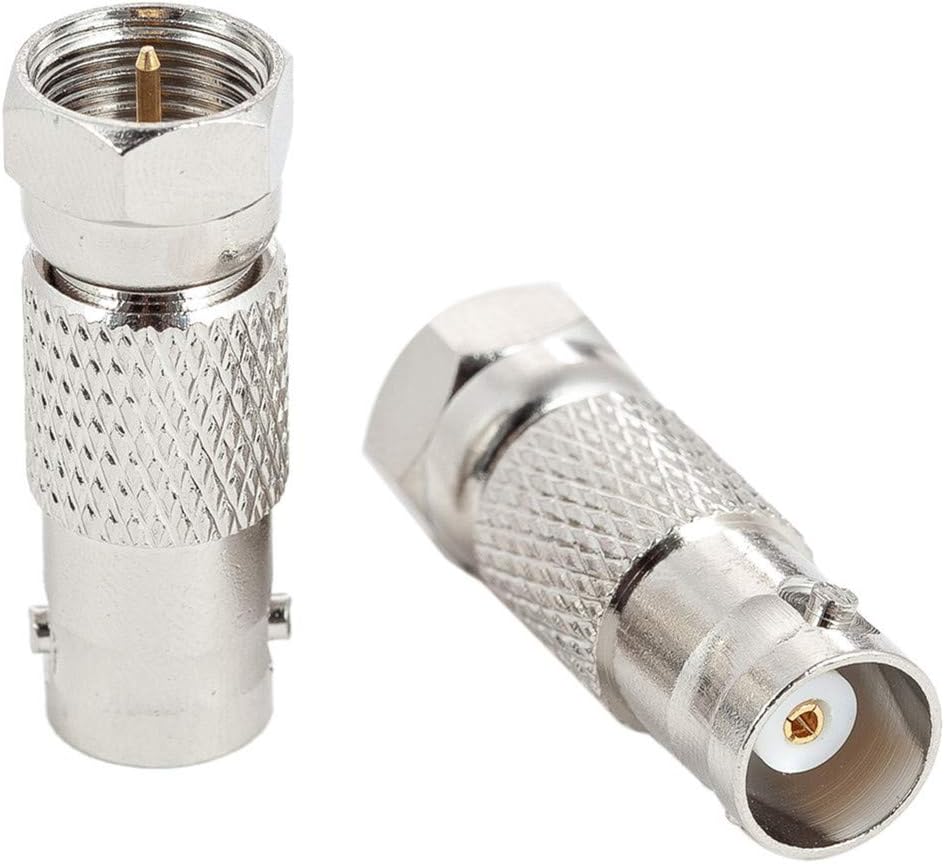

I found the source of my confusion regarding the cabling for this SG165. All of the external components are 75 ohm female. I'm missing the main cable that goes from male BNC to 75ohm male.
Had to make one. Went with a 3 foot male to male BNC cable, to connect to the female BNC labeled All Signal Output, on the SG165:
Adapter to 75ohm:
Hope this works properly.

I'm sure you are aware that the cable needs to be 75Ω coax, I think the adapter you mention is BNC Female to 'F' male.
When I worked in test equipment calibration, we found most every between gender or type adapter caused about 1 dB of attenuation, which may or may not be a consideration in your application.

I was not sure of anything when I bought this, or received this :).
There are no pictures of the included components. The manual said an F cable, was what I needed.
You're saying I'd be better off with a 75ohm coax cable, of about 3 feet, with an adapter that has a female 75ohm coax on one side, to BNC male on the other, or:
https://www.amazon.com/gp/product/B07VVG22WB

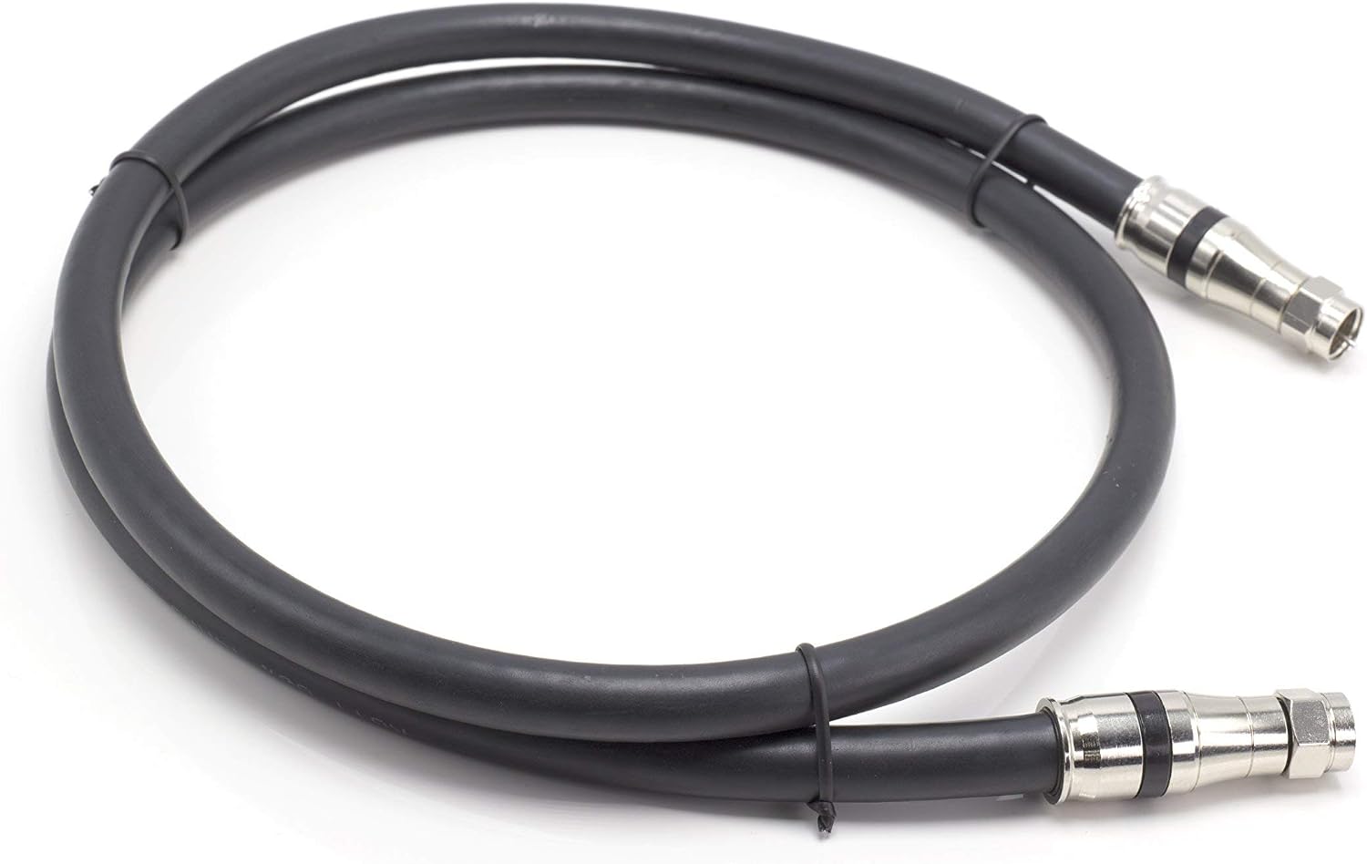

and shielded RG11 cable:
https://www.amazon.com/gp/product/B07B5JN89G
This would have less signal loss than the cabling option before this?

No need for RG11 cable, with the short length you will be using it is not needed and you would curse it every time you tried to bend it out of the way.
The small diameter BNC to BNC cable you showed earlier will be just fine even with an adapter. What is important is that you use a 75 ohm cable. Really makes no difference which end is adapted.
In the big scheme of things a DB or so loss is not a real big deal. It's FM radio not rocket science :bigok: no need for NIST level calibrations here.
