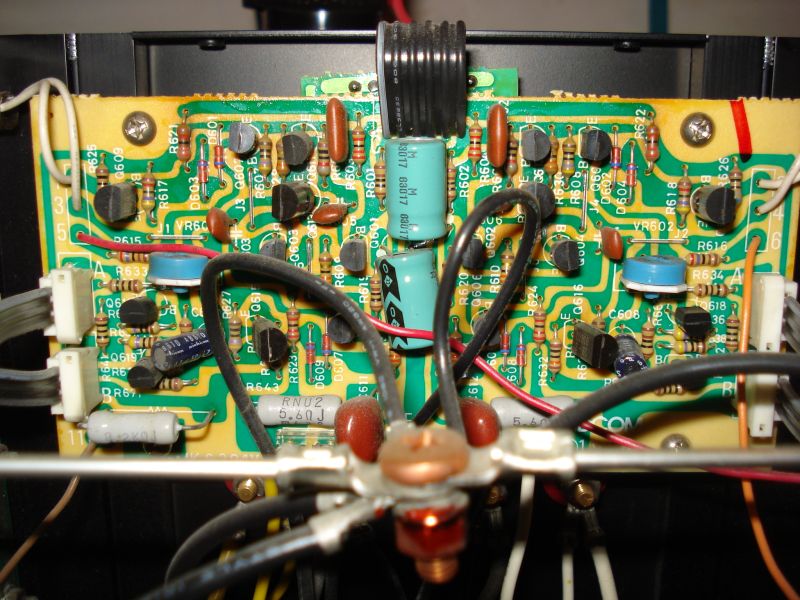

I have a Adcom GFA-555 amp that I have went through and replaced all capacitors, even the large filter caps. My dc offset is setting pretty at 9mv per channel but I was wondering if you would touch the bias.

The amp could use a bias checkup but I am having a terrible time finding documentation on adjusting it. I have a GFA-555 service manual but it contains the procedure for a PS board unlike mine. They may be similar enough that the procedure also pertains to it but I would like to run it by the forum. Hopefully some of the past Adcom techs will chime in or others who have the same board as mine.
Here is my board along with the link to the schematic:
Link to schematic: www.civilwarmedicalbooks.com/bias/hfe_adcom_gfa-555_schematics.pdf
My GFA-555 PS board:
