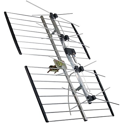

This one picks up stations at least 70 miles away from us, broadcasting on a mountain about 4000 feet higher than us, with a mountain at 2500 feet higher than us at about 25 miles in between. Not certain it will cure your issue, but it works well for us. It is mounted about 20 feet high, and the elements can be pointed in at least two different directions. We have mountains on either side of us too, separate from the mountains 70 and 25 miles away, where most of the stations are, in Albuquerque. Expensive, but so is a month's worth of cable.
https://www.amazon.com/gp/product/B00C4XVOOC

Seeing as you're in the Carolinas I'd make the investment now in time and money while the weather is still nice and put up an outdoor roof antenna. If all the stations you want are UHF then get a directional UHF only (if you don't have a directional one already). If the stations you want are all in the same general direction then you can skip the rotor. You can even buy a small digital TV from Walmart and take it up on the roof and find a location that's good for reception.

Found his web site years ago. Check out the other antenna reviews. I learned some things. Had super bad multipath, signal strength issues when I lived in the middle of town. Got the 4 bay antenna to increase received signal, and eliminate the multipath as I turned the antenna toward the stations.
