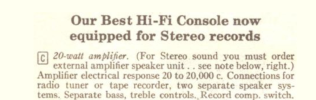

..Does anyone have any info / thoughts on the turntable and on the amp?
I want to upgrade the amp outputs but am unsure one first glance if it’s mono or stereo?
Per this thread (post #10), the poster says Mono
Not sure what the "A" denotes but this should probably be the same
Thanks! I saw these earlier but the posts seem to be divided whether this is stereo or mono. I’ll post the schematic later when I’m home, I’m sure that will be telling.
Pretty unlikely this will handle a mag phono cartridge without a preamp.
from what I can see of the schematic in the one pic I'm thinking mono but its hard to say for sure. The two piece setup with an external amplified speaker to make stereo was not an uncommon config at this time, and that would also jive with it being a mono amplifier.
Oh this is new to me, I’d love to learn a little more. We’re ceramic carts originally made so that they only needed an amp to transmit sound and not need a pre amp?
When you say this setup was not uncommon, was it just a mono source put into two separate speakers? In that case is it really stereo or more of mono going through two speakers?
Thanks for any info, always love to learn
Yep, output somewhere in the 500mv range, and they work into a high impedance input, often 1-5 megohoms. With very basic resistor or maybe resistor + cap loading they do a pretty good job of equalizing themselves to come out with normal frequency response. A magnetic cartridge is something like 5mv, or about 1/100 the output level of a ceramic. You can usually just stick a phono preamp between a mag cart and a ceramic input and have it work normally so this isn't a deal breaker.
Ceramics were pretty much standard on most consoles through the late 60s at least, only the high end stuff had magnetic cartridges. They weren't even particularly uncommon into the 1970s on lesser gear.
The two cabinet deal would have been real stereo, but the only stereo source back then was the turntable. If its got a tuner you get mono through both speakers. I have a Hoffman console from 1958 in this config, and I have pieces of a Magnavox from about the same time that was also that setup.
