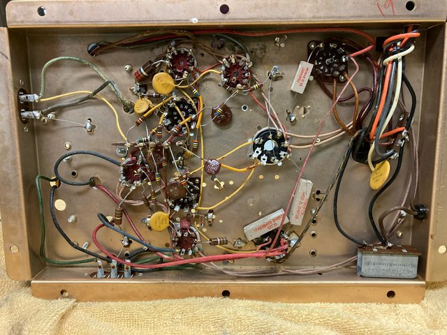

Can you post a photo of the wiring? You may have half of the heater line grounded to the chassis. With only one insulated line to each tube. They often did that in the olden days. :) This makes hum elimination almost impossible.

Mr. B, here is a picture of the amp before I replaced the can:
Here is the pre-amp after I replaced the electrolytic caps:

Your unit has paired AC heater lines. Some areas are twisted, some are not. If you really wanted to, you could redo the twisted leads and raise them above the signal lines --- to minimize picking up the hum from the AC lines. :)

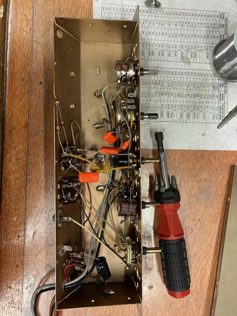

Really, the twisting and placement of the heater line will help a little. Just what percentage of benefit is amp and ear dependent. If you can live with the baseline hum, let sleeping dogs lie. I do my DIY circuits based on what has worked before. So that I don't need to go back into the unit and rewire it. :)
One heater line grounded to chassis.
Same amp, with twisted pair. Lifted off chassis (electrically and physically).
