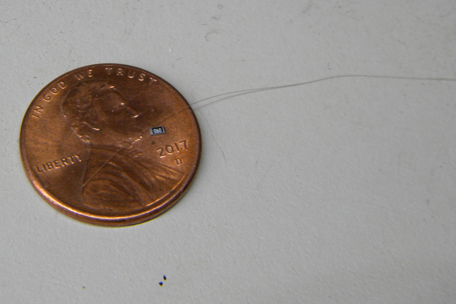

The bigger problem is getting the leads from a Simpson 260 on the parts to test. I still have hair, but it isn't conductive enough to replace the meter leads:
For resistors and caps as in the picture above, an easy way to remove them is to apply solder to both pads, then gently lay the tip of the iron next to the part so it touches both pads. Add a bit of solder across the 2 pads and gently sweep the iron sideways, toward the part. The part will stick to the tip and come off. For larger SMT components, like electrolytic caps, you need a hot air tool. The Weller 6966 is inexpensive and works well.

At my age, any SMD 0402 or larger is my limit of success when doing replacements..
