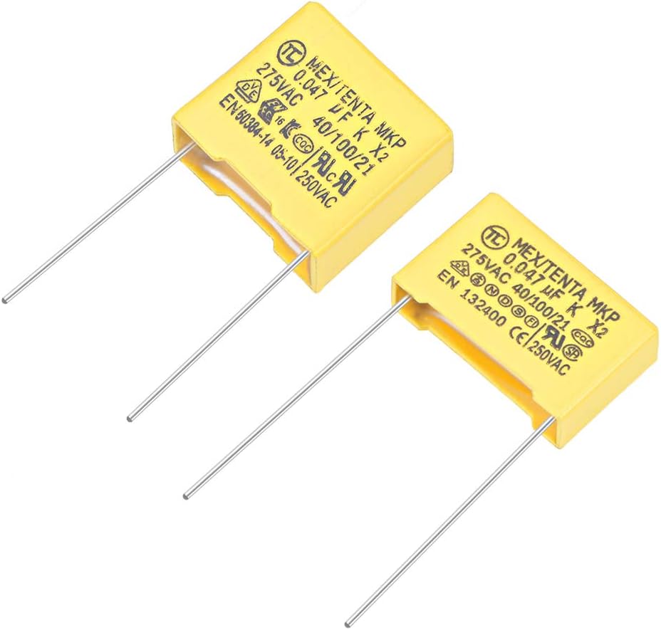

How would these work for this purpose:
https://www.amazon.com/dp/B07QXZLXV...colid=X6KL6NN4353O&psc=1&ref_=lv_ov_lig_dp_it
.047uF is fine for the original .05uF, and all that I see are rated at 275 V, and I'd think that'd be fine, too. I've read that a resistor should be installed in series; if so, what type and value should I use? Thanks for any advice or ideas on this.

Those caps will work fine. You'll notice that a 400V cap was used for 117V AC service. There is a bit more to it than that. When you shut the receiver off, the magnetic field in the power transformer collapses. This causes it to generate a high voltage spike; the cap prevents that spike from arcing across the switch. It also helps out the switch contacts when turning the unit on, since as you discovered, the switch arcs as it starts to make contact. I guarantee that switch is rare; you might want to give it additional protection by placing a current inrush limiter in series with it. And I would replace the filter capacitors in the power supplies if this has not already been done. That will give your power transformer a chance at a longer life.

Thanks for the info. So no resistor is needed with this cap? All other vulnerable caps have been replaced, and I use a power strip for equipment like this with old and hard to find power switches.

Actually,there are two different models of caps for this type of usage, depending on their circuit position;
X2,which is intended for use across the power line.
Y2,which is intended for use between the phase or neutral line and a chassis.
Most X2 & Y2 capacitors are rated in the 275-300 VAC range. These are designed for use in 120 & 240 VAC applications.
Unless specifically rated for X2 or Y2 use,I strongly advise against using any other type of capacitor for this type of service,regardless of what their DC voltage rating may be.

How about as a snubber, as in across the terminals of the switch? I'd think X2, as it's across the powerline when the switch is open.

Pop went the weasel! Be sure that the replacement cap is specified for service connected across the AC mains. Such caps meet safety approvals for fire hazard. Nor all caps with adequate voltage rating have this approval.
David: No worries, as Arts has already explained, a 275 V(AC) rating is perfectly normal for modern day X/Y type safety caps. The actual test voltages for these are quite a bit higher - for example, an X2 with less than 1 µF cap, that complies to EN60384-14, should withstand pulse voltage of up to 2.5 kV. And the same standard also includes an endurance test with 1 1/4 or respectively 1 3/4 times the rated voltage for X or respectively Y types at elevated temperature for 1000 hours, including one 0.1 second 1 kV burst every hour.
That you find higher voltage ratings in older equipment typically has two reasons: For one thing, those caps weren't specific X/Y types yet - so the circuit designers rather used regular types, that were suitable for the job. And then the rating might also merely refer to V(DC) rather than V(AC).
And yes, as Tom wrote, an additional 100 Ohm resistor in series typically isn't a bad idea.
