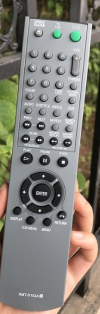

As I have many hundreds of CD's, I thought I'd try a big 400 CD carousel. It works great, except the remote control doesn't work. So I bought a generic remote from Amazon. It works ok except I can't find the disc change button. It looks different from my stock remote and it came with no directions. It's always possible this remote isn't fully compatible. Is there some sequence of buttons I need to push or some setup I need to do first to the remote to enable it to work with my CD player and change disks? It changes tracks, opens/closes the door, plays, stops, etc - everything but change disks until its finished playing the current disc. And the volume doesn't seem to work from the remote. I've tried all the buttons. Which one is supposed to change the disk? I apologize for this newbie questions.

And here is a picture of my stock remote. The most noticeable difference is the stock remote has a 3-position switch at the very top middle position, rather than a push button. I've been unable to find any of this style on eBay. Here is a picture of my stock remote:

Every button on the remote puts out a signal. And I've tried doing a reset on the remote with the top slide switch in each position and with the player turned off and on. The remote just will not communicate with the CD player. Perhaps there is some other way to do a reset that is more specific to this remote? Any suggestions, anyone?

Just to follow up and conclude, I tried 4 different remotes on this CD/DVD player. The stock one it came with did not work at all despite using the cell phone procedure above showing every button was putting out a signal.
Then I bought a generic remote from Amazon - some functions worked but many did not.
I then bought a Sony remote from eBay - one that looked as close as possible to my stock remote. Some functions work but many do not.
I then contacted Spencer from the above link. I asked him to actually test the remote I wanted to buy on the same CD player as mine. He called a few days later saying he had the same problem - no communication at all with the player despite the cell phone camera showing all buttons put out a signal. Then he discovered under the remote's batteries a 3-position micro-micro slide switch. The switch can't be seen unless one looks very closely after the batteries are removed. He changed the position of that switch then the remote worked perfectly. He told me about it but I had already disassembled my remote so I bought his remote. It worked perfectly.

2- for some unknown reason there is a hidden slide switch under the battery compartment of this Sony remote and if not set properly the remote will not communicate with the player,
3- this model of remote cannot be disassembled without damage to the remote.
