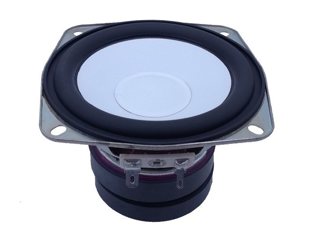

Those drivers are made by Eastech, by the way.
Thanks for that, think I've found the woofer
Yep, the make drivers for Sony, Philips and JVC. Mostly OEM for mini hi-fi/home theater systems. Got some tweeters, midrange and woofers here.
