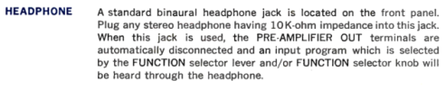

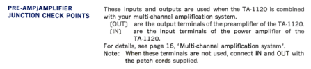

Hi . Can this amplifier be used as a power amp? In the back there is an entrance that says "junction check points in". When I use it there is no sound on my headphones .
I don't have speakers to test .
Are you using the headphone jack on the front panel? If so then the pre-amp out is disconnected so no signal will go to the amp section just to the headphones.
But it's not clear what you're doing on the back panel.
