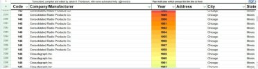

I have what I have been told by members of AK is a co-axial Cinaudagraph speaker. See post: “Instant Blues Brother-But what is it?” But now I am trying to track down date of manufacture and here’s the problem I’ve encountered.
It is stamped “468828”. Searching the web I have found several postings that the “468” is the code for the Cinaudagraph Corporation with in some cases reference to “468” as the EIA source code for the Cinaudagraph Corporation, and/or, to the RMA standard code as the basis for identifying this speaker as made by the Cinaudagraph Corporation.
Online I have found the June-July 1946 “Radio Maintenance” pdf. wherein the new RMA standard code for companies is given covering 1946-47. The Cinaudagraph Corporation of Stamford Conn. is listed therein but its Code No. is 358 not the 468 that is inked on this speaker.
Also online I have found the pdf. “1994 EIA Source and Date Code”. Therein is the “Numerical List EIA Code Symbols” as of January 1, 1994, while there is a 466 (General Motors Hughes Electronics) and 469 (Actus Enterprises, Inc.)code, there is no 468 code symbol listed or listing of the Cinaudagraphy Corporation under that code symbol.
Is there some other resource I am missing to translate the meaning of the “468828” code stamped on this speaker? Thanks for any help/advice you can provide.

468 is actually the EIA source code for Aireon, which was the corporate owner of Cinaudagraph from 1946 to 1952. This would have been manufactured the 28th week of 1948. The source code for Cinaudagraph from 1952 forward is 145.
