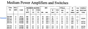

I’m working through the power supply of my jcx2900k; looking for why the speakers pop.
Question:
I see that 4 of the transistors have black , tarnished legs. Circled in green in the attached photo
I think these are matched pairs, so I have grouped them and found modern matched pairs
I can't find any subs except the matched pair ksc2383/ksa1013 for both applications
NPN 2sc1175 bottom left => ksc2383YTA sub
PNP 2sa659 top left => ksa1013YTA sub
NPN 2sd438 bottom right => ksc2383YTA sub
PNP 2sb560 top right => ksa1013YTA sub
Can someone double check my work?
Should I replace? Whether they’re good or not?

Do you mean complimentary rather than matched? Would need the datasheet posted for them to comment, unless somebody has them in their head.
For a PS rebuild I would replace them, the subs you mention are common subs that likely will work, but do check the voltage and current ratings or post the datasheet.

Yes, I meant complimentary, Here's all the data sheets

C2383/A1013 have considerably higher Cob than the transistors you are replacing. It might not be a big deal, but then again, it might.
KSC1815 would be much better for C1175. D438/B560 should be left alone unless proven faulty. They're good devices. Actually, C1175/A659 aren't known for recurring failure, AFAIK.
