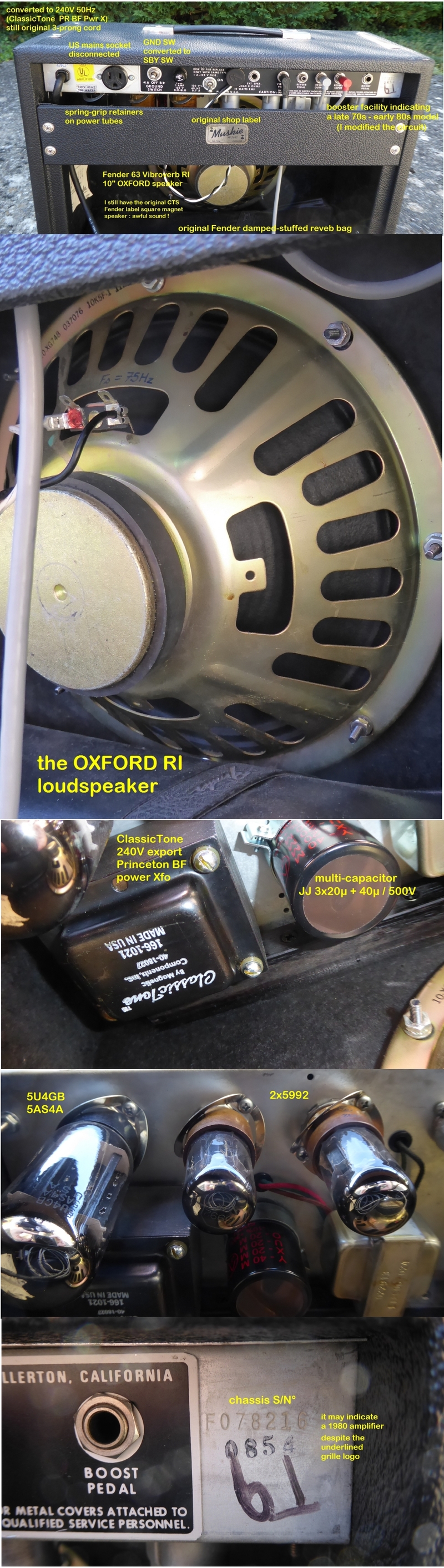

@Mr Boochie - for the occasion : my SF PR mods...
As you can see, like you I relied on a JJ 40+20+20+20 500V multi-cap. I thought that the replacement Pwr Xfo I installed was also a Mercury, but it is a Classic Tone.
T
Very nice amp.
"F0 + 5-digits" = 1980. Stamped on chassis.
Are there any numbers and/or letter codes are ink stamped onto the tube chart?
