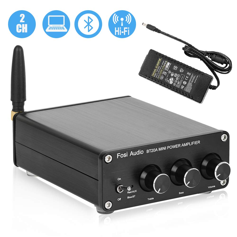

Something like this https://www.amazon.com/dp/B07BQC7GNL/ref=emc_b_5_t a pair of used klipsch or mabye dali zensor 3 connected to your pc,laptop,tablet or phone you don't need more for a loud affordable system
