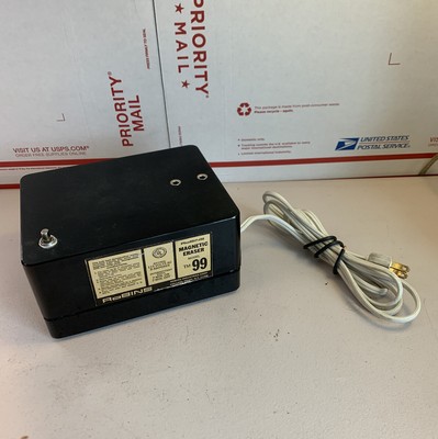

I just bought a bulk tape eraser on the bay today. Couple of question that I’ll piggyback on this thread for since it’s on topic:
1) on the 10” side do they need to be spooled on a plastic reel or can you do it using the aluminum metal reels?
2) there are two holes in the unit to center spools (7” and 10”) but there are no pins in the holes. any recs for pins?

1) No, you can do it using aluminium reels;
2) Picture may help. What model you got? Anyway it is not a big problem. You can machine spindle if you want good look :) or take correct size plastic pen, piece of wood or whatever, cut a piece and push into hole. When erase slowly rotate reel one side, then swap and repeat on another.
Found a Robins TM-99 on the bay. Was hoping to find one of those 260 models that some guys here have recommended, but couldn’t find any for sale.
I guess I’ll machine a plastic pin, should be easy enough…although what to do for the 10” NAB reels?

For 10” NAB reels simply use any NAB adapter, but leave it open if it has lock function. And I advise to attach a piece of self adhesive felt or velvet sheet to prevent reel scratching.
