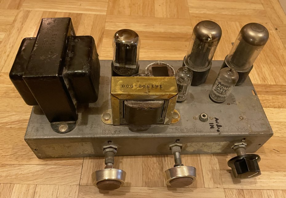

Stromberg Carlson monoblock
wa2ise
Super Member
Rescued this from the local ham radio club. A 6V6 P-P audio amp. And a 12AX7 and a 6AV6. Stromberg Carlson (at least most of the tubes were branded that). Probably came out of a record player console. With bass, treble and volume controls. Changed the 6X5 rectifier to a 6AX5, and replaced the filter cap (with individual caps below deck). Replaced a wax cap, but I didn't change the ceramic caps. Seems to work pretty well.
