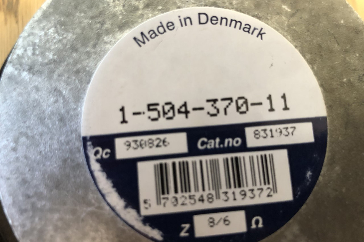

As some of you may know from the Sony SS-M 3,7,9 speaker owner role (roll) call thread I recently bought a nice pair of Sony SS-M3 speakers and really think they are keepers. So much so that I want to build a clone of an orphan I already had. I have posted in the orphan speaker bingo to see if there is a single out there that would like to join mine to make a pair. I haven't had any replies so I have been gathering parts to try and make a clone using my meager woodworking skills so my orphan has a twin.
So far, I have a tweeter that has some damage, but I think even I can get working again with a little soldering work. If not, similar 4 ohm Peerless tweets are plentiful out there and I don't think finding a similar pair would be much work. I also purchased SS-M3 crossovers for the midbass and for the tweeter from the auction site, so that's sorted. What I don't have is the midbass driver, which is basically a 6-1/2" driver with a butyl rubber surround and RMS max of 120 watts. The fact that 70s Rockfan built clones of the SS-M7s, which look beautiful by the way, and that RedSquare is working on a pair of SS-M3 clones, got me thinking I could tackle a similar project.
So, I've been looking for a suitable pair of 6.5" drivers. I've been driving myself nuts looking at the offerings from Parts Express and Madisound -- especially Peerless brand as they manufactured the originals for Sony. Also looked at Daytons. Some seem close, for not too much money. I haven't even started building the partner to my orphan. I wish I could just buy one 6.5" midbass, but believe it would be best to buy two so they are identical and keep the midbass from my orphan as back up. I've also been looking at the used market on eBay for 6.5" rubber surround midbass drivers from other quality speakers from other manufactures that may just work, but I'm just not sure what might be best. I know there have to be better components out there, but still want to keep the clone (and it's orphaned twin) as close to original as I can.
I use my current pair of SS-M3 with a Sony 2-channel STR-GX10ES for my audio setup with other ES gear including a PS-X555ES turntable and I am really enjoying them. I'd like to incorporate a second set into a HT set up I think.
What are your suggestions for 6.5" midbass, preferably with black cones and the rubber surrounds like the originals. Getting something with inverted dust caps is probably asking for the moon. Anyway, coming close to the specs that will work well with the OEM crossovers of the originals is my first choice. A reasonable cost upgrade driver that works with the crossovers would be second. Any other brands of speakers where the parts like used 6.5" drivers aren't unobtainable would be considered as well.
I look forward to hearing from those who know a lot more than I do about such things.
The orphan, needs a refresh to the veneer or new veneer when I get the clone finished.
The part number for the driver for which I need a copy or two similar substitutes
Without knowing the T/S parameters of the woofer, it'll be a crap-shoot finding something suitable. Your best bet might be to search with Search Tempest or HIFI Shark, and find a beater pair of SS-M3's.
I guess the next best thing might be a new Peerless woofer. Or, go cheap 'n cheerful, and try a Newark/MCM woofer. The only other suggestion that I can make, is get a true custom woofer through Misco. You can buy off the shelf, or Misco can custom manufacture what you need.
Luck!

The woofer that you're looking for is a Peerless 831937 probably from their very old CC line.
This looks similar but your should try to get the T&S parameters from the old one and match
them as best as you can:
https://www.parts-express.com/peerl...MI-t_BpOvw5AIVz8DACh23xQKnEAQYASABEgK51vD_BwE
Is the box sealed?
Thanks for your response
The new Peerless you linked to is close, but really looking at vintage because the frames are usually round (so looks original) and have the four holes that my Sony has. Of course that doesn't guarantee the bolts will line up.
Also missed the part about, "Is this box sealed? Answer is yes, sealed, not ported.
