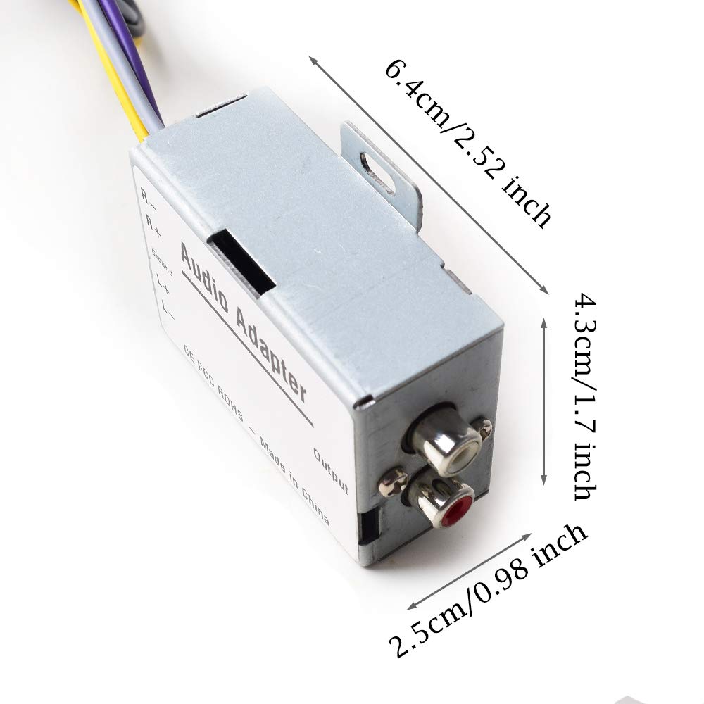

A speaker level to line level converter/voltage divider will work if there are not high level/speaker level inputs on the sub.
One can buy one from Amazon et al for $10 - $20.
They're pretty common in car audio but serve the purpose in this case as well. Kicker, Rockford, et al.
Connects to the amp speaker terminals along with the speakers, then connects to the sub using RCA cables.
Google (or look on Amazon) for "speaker level to line level converter" and it should make more sense.
So both the speaker wires and the wires on the convertor BOTH hook to the amp. And the rca jacks from the converter I would run rca cables to the sub rca imput ?
Yup.
Those converters sometimes have power rating, e.g. 50 watts or whatever. If you tend to crank it up be sure the converter is appropriately rated.
