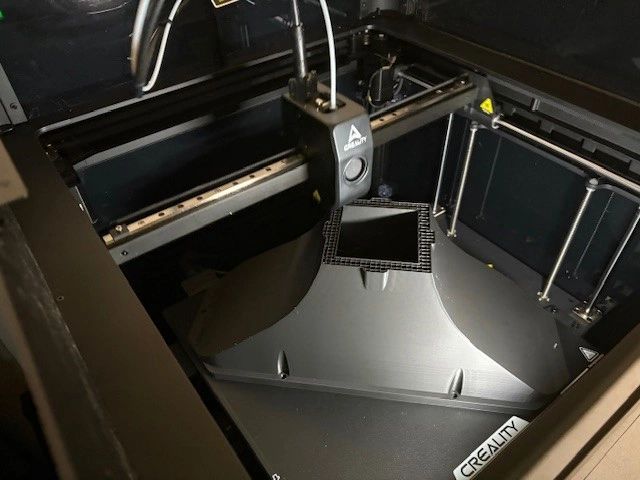

Well, final (?) update to my Super Heresy journey.
I installed a pair of B&C DE10-8 drivers with "original" style elliptical lenses.
This set up is very different than the K-77's. Things have smoothed out even more top to bottom. The mids don't feel quit as harsh and the highs have smoothed out as well. Less separation between the 3. The highest notes don't seem to come out until (it seems) they're intended to. Less top end "hiSSSsssss" and more smooth "ttttthhhhhhssss".
After listening to stock H1's daily for the past 10 years, this is going to take a bit of adjustment :)
Still very pleased with this new setup.
Thanks to my friend Dave for the new lenses and to ClaudJ and Dave in Tennessee for their work on the SH recipe.
DE-10?
How did you get them to fit? I have DE-120 on Dave’s SMAHL. Tried the De-10 and it will not clear the k700 mid horn on my H1.
Or is friend dave not smahl dave? Those horns look printed

Yeah, printed by Dave Harris.
I think they're a bit deeper/thicker than the sMAHL's, which sets the bigger driver back enough to clear the k700, so I get just enough clearance.
These are a great, cost-effective alternative.
The more I listen to this setup with the printed elliptical lenses, the better they get!
They aren't as "bright" at low volumes, but really shine at higher volumes. Seems like they dampen and manage resonance and provide a smoother, less harsh sound than the k77's.
I haven't figured out how to get my mid horns to shoe in next to the DE-10 yet. When I do, I will reach out.
Currently it works with DE-120, DE-110 Celestion CDX1-1412, Lavoce DN-1.142, Eminence APT-50, and Dayton Pro NEO-8

Hey Dave.. Is your heresy test mule a version 1 or 1.5?
The tweeter cutout was moved about a 1/4” higher on the H1.5 resin k701 version to clear the mid horn flange.
