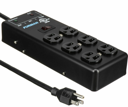

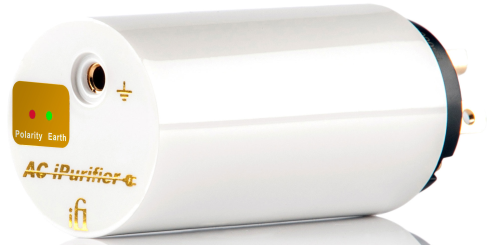

If you have slightly noisy AC this works... I use two
I Plug those ^ ahead of this
Works for me
