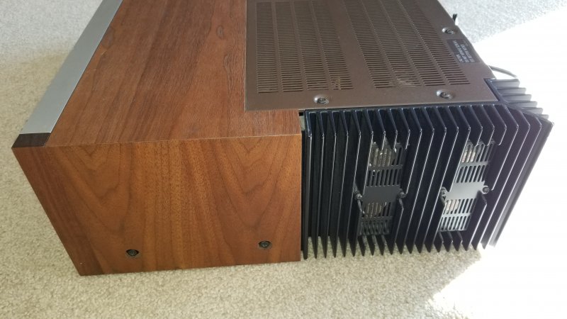

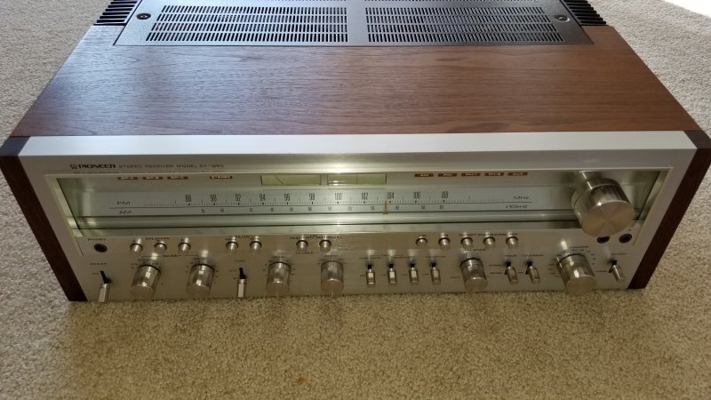

Thanks Robert, those comments are reassuring that I have a unique 1250 as I waited a long time to find one that wasn't beat up.
I'm attaching a few pics so everyone can at least see what were're talking about. These are right before it was boxed to go to Robert; I don't have any from it
sitting in my system, as I haven't really used it:
