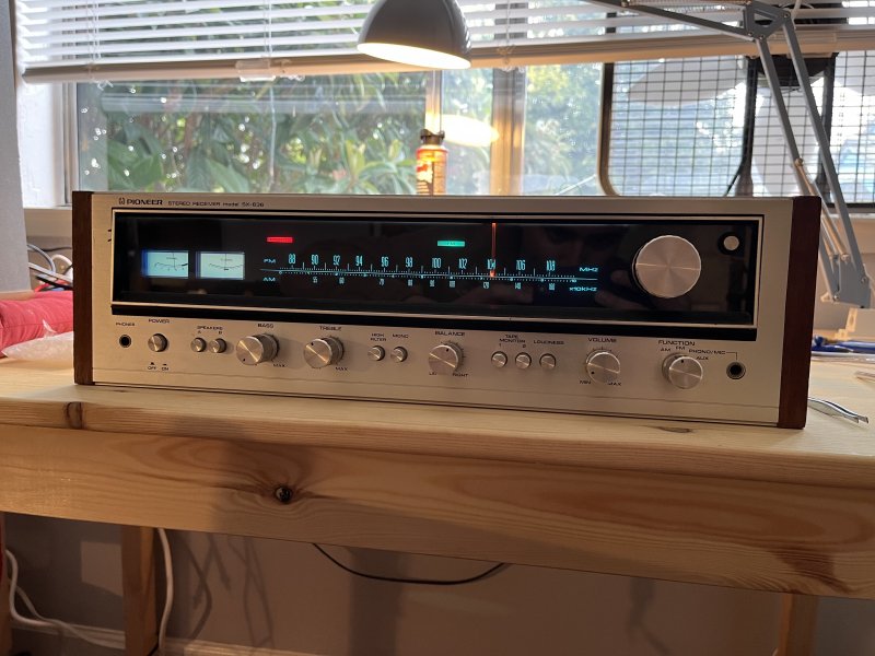

Gentlemen, great news. I have completed the following using your guidance:
-Replaced the 2SC945 and 2SA725 in the tuner. There were indeed two 2SA725s in there - glad we got them out!
-Replaced 2SA777 and 2SC1509 on the power amp board
-Replaced 100ohm pots with modern Bourns equivalents
-Replaced all tantalum capacitors with Kemet film (I know, not WIMA, but it's what Digikey had)
End result: everything sounds very nice, tuner continues to pull in lots of stations (and is sounding VERY warm and smooth, might I add). I also re-transistored the tone control board and it made more of a difference than I thought it would -- the receiver sounds smoother, slightly warmer, and a bit bassier than before.
We have two remaining issues before I can call it good:
-First, any guidance on getting the pointer dial to align with the actual station the tuner is tuned to? The top half of the tuning range is fine, but the bottom half is off by ~.2 to .4. Is it safe to try to fine-tune this, or is this a "tuners will ruin your day" item?
-Second, and more importantly, we are having an adjustment issue on the power amp board. I am not sure what VR1 and VR2 adjust, is it idle current or bias? Either way, the service manual tells me it should be 20mv, but I can't get it to go any lower than 25mv on either channel. Is this a serious issue? Did re-transistoring the power amp board throw that adjustment range off? If so, anything I can do?

VR1 & VR2 adjust IDLE CURRENT.
there is NO dc offset adjust.
On semi transistors has been migrating the Fairchild transistors to their chemistry, which has a lower overall Vbe by a few millivolts.
This upsets the calculations done back then by the Pioneer Engineers. Idle currents are more easily reached, and there is slightly less voltage drop per stage.
You could remove D3, substituting a piece of wire, and then seeing of the 100 ohm trimpot has enough adjustment range.
Frankly I would leave it at 25, and not doing some risky fooling around. If that goes open circuit - it's the smoke and flames thing....
