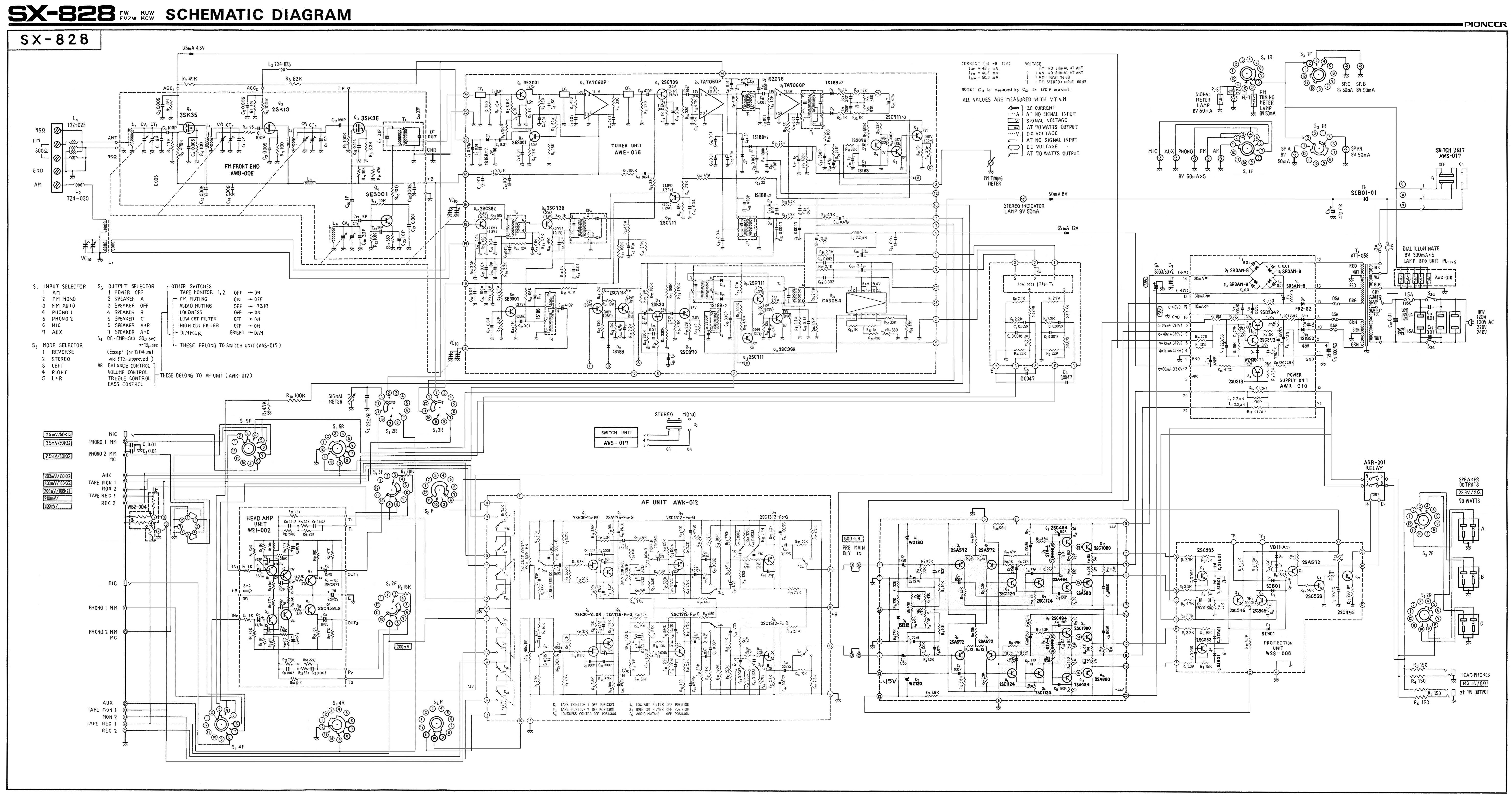

WOW! I have a 828 doing exactly the same thing.
And the SX-828 has some of the same historically trouble-making devices.
The 2sa725 and 2sa726 are annoyances, while the 2sc1451 is a definite HAZARD - as IT will overload SMOKE your output circuits.

Picked up an SX-636 from a fellow AKer put it on CL cheap after he tested it and got crackling. He put it on CL for cheap as a fix and repair. Never heard that part myself, just took their word. Opened it up, saw the 2SA726 differential pairs looked like one transistor had been replaced with what I gather was an NTE replacement, and the 2SC1451s in each amp channel. Replaced those 6 transistors (with KSA992 and KSC3503), put a new power cord on it since unit was bought cordless untested. Brought it up for the first time for me, checked the DC offset was below 20 mV in each channel, checked the bias, unit sounded good through headphones, then with speakers sounded great. Apparently extracted off a scrap pile behind a Goodwill, had issues got its cord cut and tossed. With the new transistors it works well and the case was in good shape.
