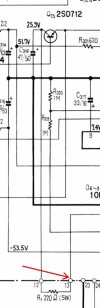

Fuses all good?
For Q25 go back to the large 220 ohm resistor R1 mounted on the heatsink and confirm that you have about +50 volts at pin 13.
If you do then measure the voltage from across the resistor (pin13 to pin 12) if all is well you should have about 25 volts across it.
If you have the full 50 volts across it then there is a short downstream of pin 12.
For Q19 and Q 20 you need to measure the voltage on both sides of R317 and R318 to confirm you have proper voltage coming in and the resistors are good.

[My best guesses after looking at the service manual.]
New numbers:
Q25 E = 13.55v, B = 14.23v, C = 28.6v
[This one is no good? Replace?]
Q19 E = 40.2v, B = 40.8v, D = 50.5v
Q20 E = -40.3v, B = -41.0v, C = -52.4v
Pin 16 = 40.6v
Pin 15 = -40.4v
Pin 13 = 51.5v
between 12 + 13 = 22.8v
Pin 12 = 28.6v
R317 top = 51.6v (nearer base of Q19 - notes for myself)
R317 bottom = 50.5v (connected to collector of Q19- notes for myself)
[R317 seems to be OK?]
R318 top = -53.3v (near Pin 22- notes for myself)
R318 bottom = -52.3v (connected to collector of Q20- notes for myself)
[R318 seems to be not OK - collector voltage isn't right?]
