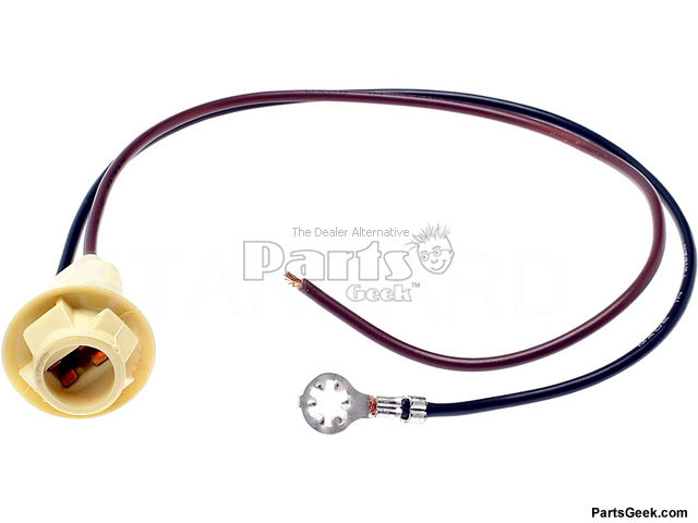

I went to change the bulb near the meters on my SX-780 and when I squeezed the socket clips, one side crumbled. What to do now? Can I get a new socket and is it an easy replacement? I'm not seeing how to get the 4 wound wires off the socket posts.
As with anything, it's easy if you have the parts and tools and know how to do it. The wires are what's called "wire wrapped". There's a tool for that. A manual tool is about $40.00 and they go up from there. Wiki will tell you about it. Most advise leaving them alone because of the expense and skill to redo them. I have the tool and wire so I redid mine. I got used sockets off ebay. If you don't know anything about it then i would advise to just unwrap them with your needle nose. Replace the wires with fresh wire and use solder.

Get a license plate or side marker lamp holder from any GM in the junk yard, solder in the pigtail, and forget it. They have the bayonet tabs for retaining the socket into the acrylic light bar.
Thank you both for the good tips. I guess it will come down to what I can find quicker and/or cheaper. I'm guessing the gm light socket.

Ok I went to O'Reillys and they had the Dorman 85814 GM side marker sockets. 3.99 each. Wasn't in the help section like other stores are. Found these in the bulb section.

That one may require a little trimming on a couple of the latches, but an X-Acto should work nicely. Those that I recall had a fairly soft (vinyl?) body and could be cut and formed pretty easily.

They are pliable. Soft vinyl. I was looking at the trimming. I dont need them yet...but I have a burned up diffuser out of a 780 I am going to cut the socket and test fit soon. I will post pics then.
