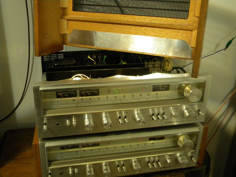

Since you are already under the hood, you might want to consider some routine maintenance.
The output packs can usually benefit from a fresh layer of thermal paste.
The solder joints at the power supply regulator transistors should be inspected closely for signs of heating, and re-flowed if necessary.
Check the offset (DC balance) of the output devices, and adjust as necessary to get the offset in each channel as close to zero volts as possible.
Glue a strip of aluminum foil to the inside of the top bonnet, just above the location of the dial illumination lamps to prevent further heating of the wood veneer.
Lubricate the dial cord guide rollers, and apply some beeswax to the dial cord where it passes over the tuning spindle.
Clean out dust and debris as best you can.
Clean and exercise the switches with a de-oxidizing cleaner, and apply a potentiometer/switch lubricant afterward.
I can come up with more if you get bored.
And now looking through the service manual I see that if I had read more carefully I would have seen the diagram pointing out that the timing capacitor comes off of pin 8 of the protection module to ground, and is thus C317.
Thanks for the maintenance list - I see symptoms relating to a lot of those tips (squeaky tuner dial, slight scorching of the veneer on the case above the lamps). I'll work through the rest.
