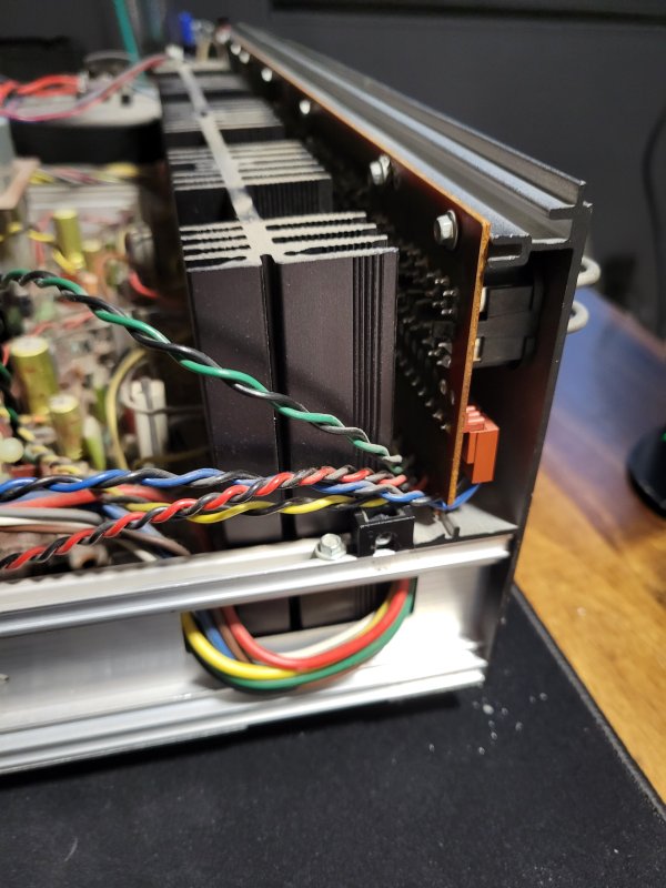

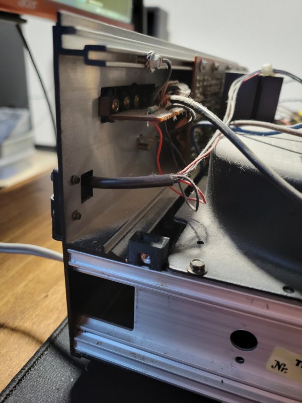

I have a Tandberg TR-2080, purchased it off of my uncle (the orignal owner)....had for many years and all of the sudden the side cover got loose. They used a plastic nut holder on the rear side covers to hold the nut in place and it was shattered
I duplicated and produced a 3d printed model to replace the broken piece (see images). If you run into the same problem feel free to message me and ill send u a printed model (just pay shipping) or the design if you have your own printer. Hopefully this helps someone in the community

Nice job on the panel clips. The 2080 I worked on had broken ones too. I cobbled it together with some glue and nuts but a proper part would have been nice.
