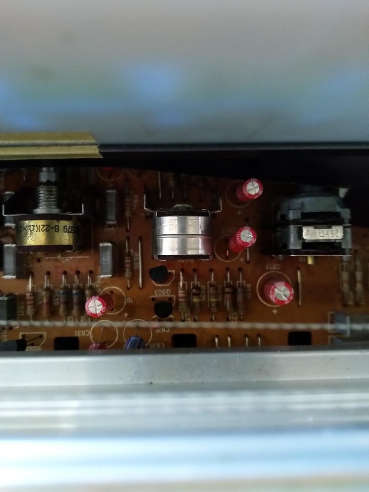

Hi, I have a TR2040 that has the balance pot shaft off. The axle (grey plastic center bit) is flat with the metal housing. I tried to glue a bit of plastic to the grey center bit but it won't stick when turned.
I would like to replace it with a new one. What specs should a replacement balance pot have?

Maybe post a pic showing the damage etc... Finding a replacement can be a PITA, need to have the correct solder connections
(pins, lugs) also shaft length, diameter, centre dentent? stepped? flat shaft or knurled.... Would guess a panel mount...
Start with the bourns data sheet, try and identify the key lengths etc.

Thank you mbz. This is how it is. As you can see the knob and shaft are loose.
I was able to scrape off the glue remains with an x-acto knife , use a 2mm drill and very carefully make a small hole in the center of the axle.
With a small torx screwdriver I could turn the shaft a bit to the left and checked with headphones for center alignment.
Solved :-)
(I never use the balance control anyway)

Suspect most people don't (need to) use it. If the part is unreplaceable, a common hack is to replace the pot
with 2 fixed resistors, 2x12k (or is it 2x25k?) would be suitable in this case, one from input to wiper(middle pin), the
other from wiper to GND, replicating,
That way the balance would be permanently set to centered. The original pot can remain inserted for appearances.
Just need to snip off the pins so the resistors can be inserted. I'd suggest still doing a parts search.
EDIT: maybe something like this from mouser, 652-PDB182-K420K203B 20mm shaft, knurled no centre detent. Would need to check pin spacing
The original pot has a long thin shaft, something like 3" long and maybe 1/8" diameter. Replacing them with off the shelf pots while still having front panel control access will take some doing.
Should be able to sub a balance control from any of these models, I believe they are interchangeable: TR 2025, 2030, 2045, 2060.

Thanks! Maybe in future I will fabricate a new shaft but for now i will leave it like this. A picture is owed:
Yes there are better looking examples about, but this one is mine :-)
This is an older thread, but I still thought I would post because I have a fix for some cases of the TR-2025/2040 balance pot issue. Note that this fix is effective only if the gray socket section into which the rotator rod fits is generally intact, allowing, of course, for stress cracks that can be repaired by applying the technique described below. If sections of this housing have broken off in any way, it is not viable. It seems like this pot may have been designed for various applications, hence the detachable socket/rod arrangement that might accommodate different lengths. The problem is that the serrated plastic socket cracks over time due to torque stress, leaving the attached rod/shaft unable to rotate the pot. To fix, follow these steps:
1.) Detach the rod from the pot completely by pulling straight out.
2.) Allow it to rest inside the chassis at an angle temporarily, so that the threaded tip of the rod is accessible.
3.) Rotate the rod with the outer knob slowly while applying a coating of two-part clear epoxy resin. The viscosity of the resin is such that it will hold its position as this is done.
4.) Carefully reinsert the rod into the socket.
5.) Apply a second resin coating to the outside of the socket to mitigate any tiny cracks that may be present.
6.) Despite any "quick set" claims, wait a total of 72 hours for a full cure.
There are some caveats to the process that can't be ignored. First, you must insure that you start with the pot in its "center" position, which may not be easy to find. Second, don't fool around with other high-strength glues that you think might also work, such as Pliobond or cyanoacrylate/"Superglue." Believe me, they will not handle the necessary torque. Finally, this job is not easy, as it requires a certain amount of patience and dexterity. You are likely to become frustrated at first, but know that a fix is indeed possible.
