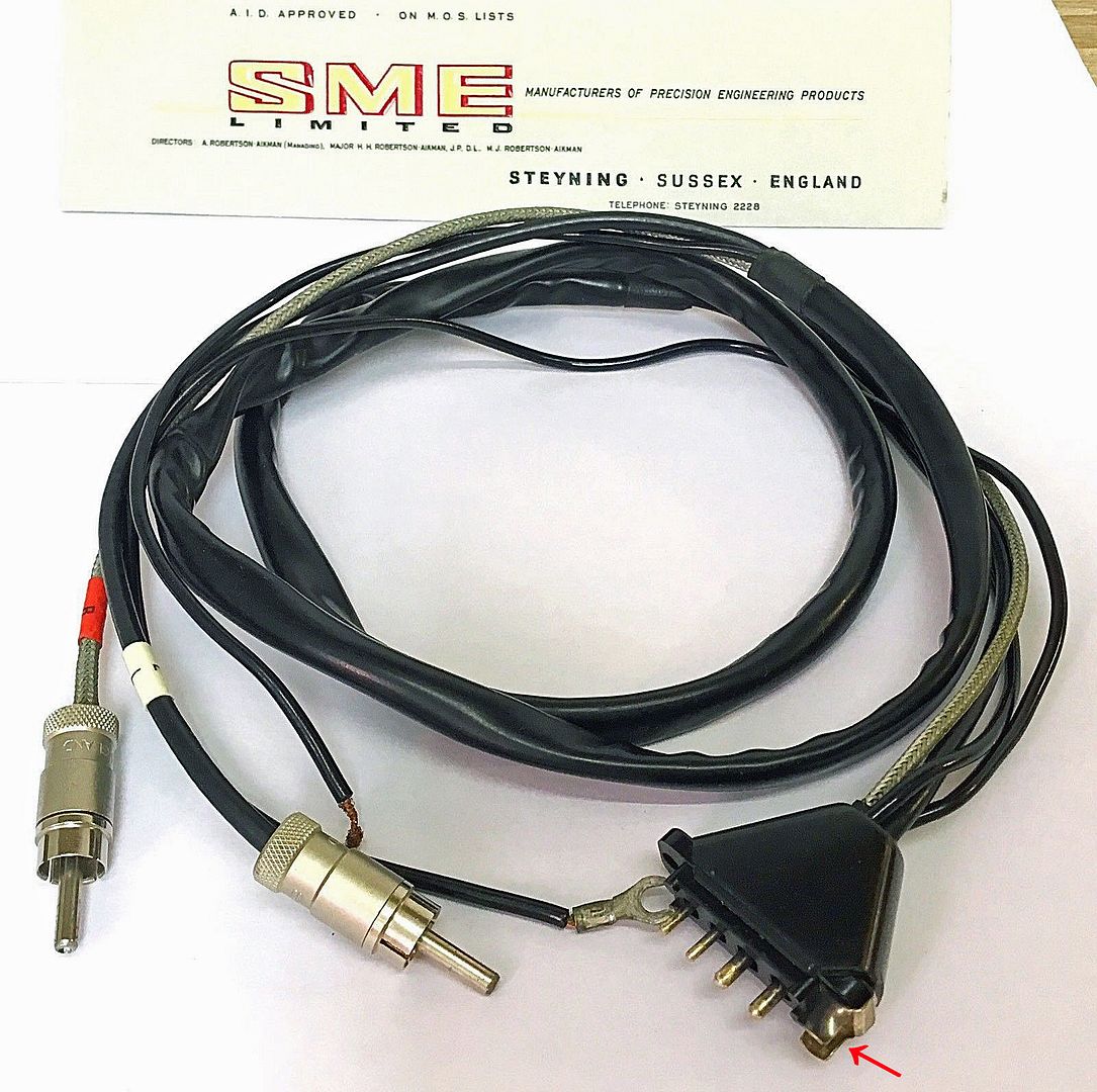

I suggest you get something like this:
You’ll have to check though that the connection from the tonearm has not been modified and still accepts the 5 pin connector. If your arm is a Series III, i think you’ll be fine with regular rca cables and a ground wire. Best to have it checked by someone knowledgeable. It should be a simple fix.
thanks for sending this through. I’ve had a look inside the unit today and it looks like the original cable is partially intact, as the end connector from this eBay post is present (picture 1). It looks like the cables from it connect first to the chassis of the board (picture 2) and then out again, with the three cables being brought together under one cover which leads to the 3 pin output from my earlier picture (picture 2). This makes me wonder whether it would be possible to just remove the jacket from the outgoing cables and replace the 3 pin connector with two RCAs and a ground connector (but as a bit of a newbie I appreciate this may be complete madness?)
The main power supply is a bit of a mystery as it just seems to come out straight into the kettle lead from my earlier picture.
As always, thanks for everyone’s advice and any further thoughts would be much appreciated!

I would terminate the SME connector-cable with what you want to use be it wiring to a pair of RCA plugs with a ground wire to the preamp or a pair of RCA jacks and ground terminal on the back panel of the turntable to be able to use any interconnects you want.
Things to consider:
1) The wiring should be shielded, even lower level turntables have metal sheets or foil on surrounding panels to protect the open wiring from RFI and EMI.
2) The SME connector at the arm should be wired in such a way to allow the movement of the table with little restriction to keep the suspension in the mix for best phono playback.
Magnepan tonearms have a jumper from the tonearm connector to the main wiring harness about 7” away to allow the movement of the turntable in suspended machines. The main cable is physically attached to the base and the jumper is free to move as necessary with the turntable suspension. The Magnepan jumper is made of something like the Mogami 2739 ultra-flexible mini cable, available on the bay: Mogami 2739 - Ultraflexible Miniature Cables - 2.1mm OD - 4 Core & Screen | eBay.de but you can probably use the wiring with the SME connector with the SME wiring and additional wiring positioned correctly.

Okay, this is really helpful thankyou! As I work through the process I may be back with more questions but I’ll have a go and see how I get on. Cheers!

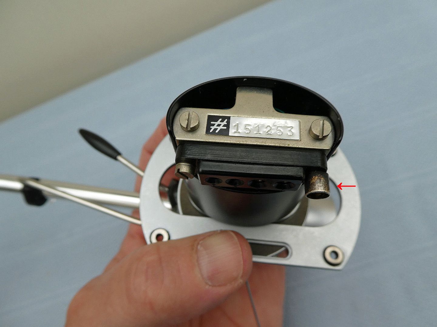

The two fuses, one is used for 120V and one for 240V mains. I think it is in the manual.
The power system is not grounded. The turntable and tonearm are grounded through phono leads.
The SME wiring has a ground wire at the tonearm end that is connected to the turntable chassis.
If you have this style SME connection, be sure the split-piece is tight over the collar. This is the ground connection for the tonearm.
