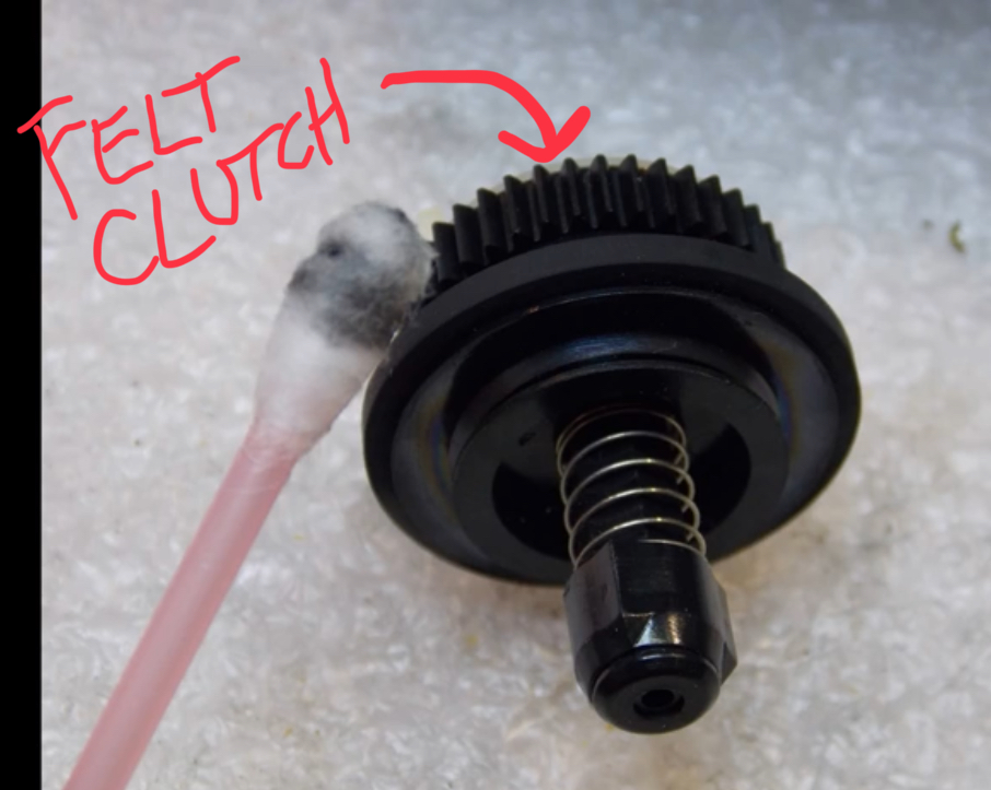

I have a CX-350 that I replaced belts on, I bought off ebay for $15 and besides the belts the machine is super spotless! The old flywheel belt basically turned to tar and was stuck to the motor and flywheel. With some rubbing alcohol and time I got it all cleaned up, put on new belts and was doing great. Fast forward a few days. The machine started "chewing" tapes. The reel table for takeup when playing has essentially no torque to it. The capstan, rewind and fast forward all work great and solidly. Could the clutch you mention be so worn that no torque gets applied? How hard is the removal of the reel table for inspection? TIA

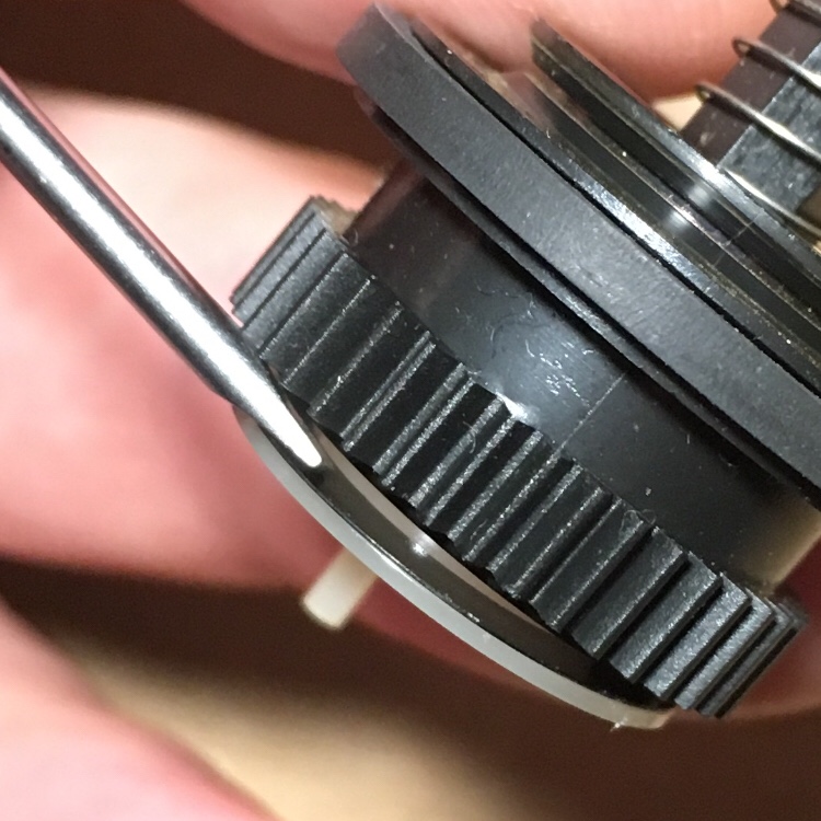

I tried to pull this apart on my one today could not remove it any suggestions??
Ok worked it out there’s two black tabs you press to lift it out
I see the felt that has been mentioned I flipped it around and cleaned it perhaps that will suffice rather than replacing it entirely?

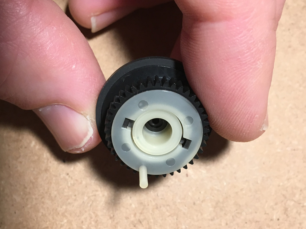

success here for anyone in future this might help.
I disassembled the reel table clutch mechanism I found that maybe the plastic has expanded over the years and was stiff to move freely I noticed that hen watching it in play mode it would not move freely like it was binding causing the auto stop to activate at play or fast forward after a few seconds. I cleaned it and added some machine oil and reseated the original felt but swapped its side and now it works well
There’s a few steps involved
Remove the cassette door
Remove the silver back plate where the cassette sits two screws at the top
Remove counter belt
Carefully remove clip holding in the reel table
Pull out the reel table
Try removing all the old grease first and reapply and use fine machine oil for the shaft the reel table sits in and dissemble the clutch and clean and reassemble you may get lucky good luck
