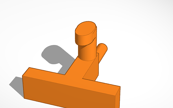

The Turntableguy in New Zealand sells replacement lid latches for $60NZ each. He calls them lid catches, but they look the same to me. I've thought about 3D-printing some replacements, but haven't yet.
