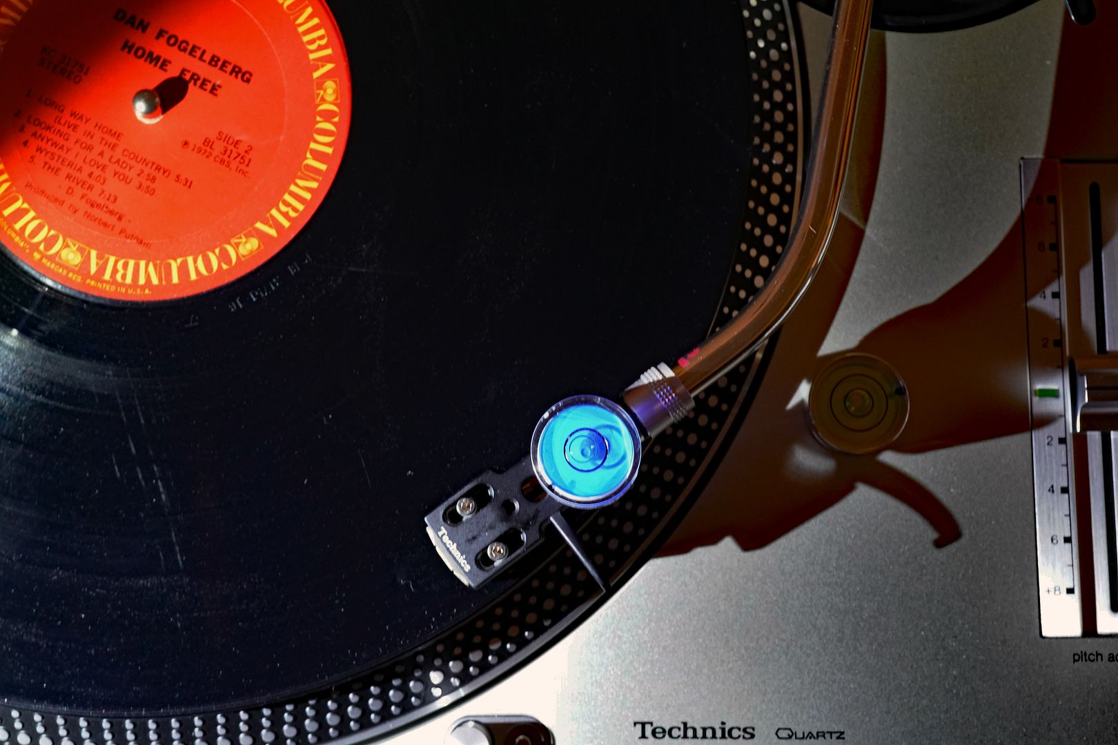

I use one of these to check the vertical and horizontal (azimuth) tonearm alignment.
Adjust the counterbalance while using the bubble tool --- so the tracking weight is still what you will use. In other words, you must compensate for the weight of the bubble tool.
A smaller bubble tool is probably better.
Bubble Spirit Level.
