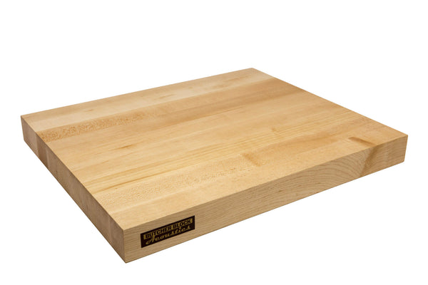

I put some of these Mnpctech isolation feet on my SL-1300 resting on a Butcher Block Acoustics isolation platform and have had very good luck. Using an Empire 2000 / E 111 cartridge with a Darlington Labs MP-7 and very much enjoy this combination.

What is the platform?
Butcher Block Acoustics 1.5 inch maple.
