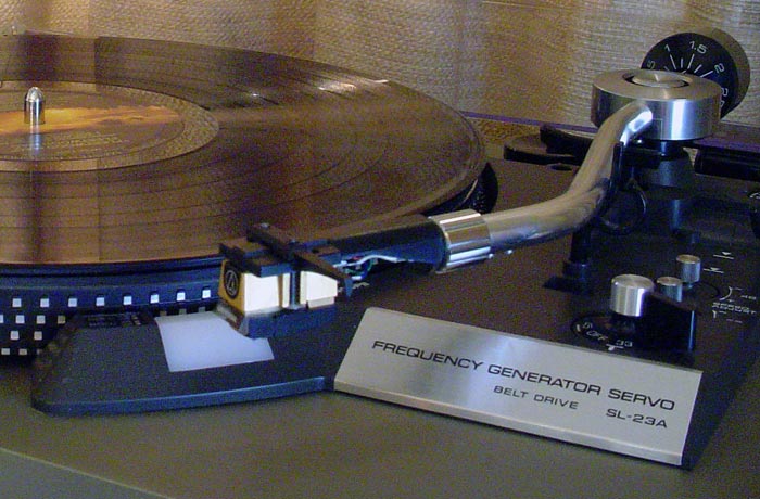

Just some upgrades to a pretty basic vintage TT. There was a short in the RCA cable so I took the opportunity to upgrade to terminals rather than a fixed RCA cable, upgraded the ground terminal and power cable.
Here's the before:
And the after:

Parts used (from Parts Express):
Power Cable:
>Parts Express Figure-8 Snap In Non-Polarized Chassis Mount AC Power Jack $0.81
>AC Power Cord NEMA 1-15P to IEC-60320-C7 18 AWG 2C 10A SPT-2 125V Black 6 ft. $2.98
Gold RCA Jacks
>Parts Express Chassis Mount RCA Jack Pair $6.99
Ground Connector
>Dayton Audio BPA-38SN HD Binding Post Banana Jack Pair Satin Nickel $5.59

Biggest issue with them is usually speed controls going wonky. Your table goes weird, cleaning those pots will usually bring it back to life. They're also pretty particular about replacement belts, so go for the closest match to original dimensions (including thickness).
PS - not to pOOp on a good looking job, but you've added a LOT of capacitance to the table's inputs. Be interesting to do a before/after comparison. I've replaced a few cables on tables, but I always use minimum length component type cables (lowest capacitance commonly available), soldered direct. Only exception might be if I'm using an external stage - still important to keep the cabling between the table and stage as short as possible while matching the OEM capacitance, but not so much on cables running between the stage and pre-amp.

Thanks. Appreciate the feedback and I’m sure you’re right but I don’t hear the difference. My main goal was to make it look better and it was a fun project. I wonder what the difference is between the 23 and 23A is?

Looks nice and you did a good job on that. I am however of the belief that the more places you have connections the more problems and resistance you add to the circuit. As above you may have changed the capacitance but depending on what cartridge you have it may make no difference. Many tables do come with connectors on the back but I suspect they do that to cut cost and then you need to buy another cable which they up sell.
I think you’re right. Next time I’d skip the connector and go direct. Live and learn I guess. But it looks cool!
