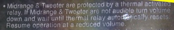

Couple things have jumped out at me:
1. There *is* a thermal protection unit present... but it's intended to protect the unit if things get too hot, from too high volume, which is not the issue here
See photo:
2. The issue now seems to be mitigated a bit, but is still present.
Now what normally happens is: Turn the amp on, play media, the tweeter and mids will be muffled or off, but pushing the volume up to -30db pops them right back into play (that's way too loud though for normal listening).
So I'm just... confused what to do next to resolve this so that *every* time I turn the amp on, the speakers JUST WORK.
And that there's no more dropouts *during* listening, so that I don't have to fiddle with settings and annoy my guests.
I have isolated the issue to the speakers, and NOT the amp(s).
The ONLY possible issue left would be cold solder joints? See photos.
I am otherwise stumped. Is this perhaps why older amps would *pop* when you turned them on, to prep the speaker into working?
Thank you for any help from anyone.
Sorry to bump an old thread, I can't edit my old posts, but this is actually an issue with the SB-A31 speaker module as shown in the later photos. It's an issue with the thermal protection module, effectively it's failing. I'm currently trying to resolve replacing all the resistor/capacitors to ensure the unit functions perfectly, just wanted to provide further information for anyone that comes across this. I'll be making a further post to discuss more in depth.
