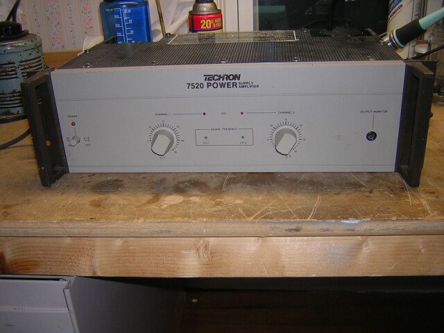

Techron 7520s:
These are industrial amps. They are dead ringers for the PS-200, except for the brown face plate and labeling, and the BNC inputs rather than phono jacks on the back panel.
Functionally, the only difference I see is that the Techrons will function down to DC, and the PS-200 has a low-frequency protection circuit. According to the PS-200 specs, the low frequency protection is defeatable with an unspecified modification.
So, any of you old hands out there know about the low frequency issue? Is there a jumper somewhere that I can change? Is there any hazard to using these Techrons as audio amps, sans the low frequency protection?
They sound great, BTW. :music:

GE used Techrons for MRI systems too, at least into the 90s. I expect you are referring to gradient amplifiers, which apply gradient fields to impart spatial encoding to the MR signal. MRI amps are constant current devices, which are typically used stacked and can swing up to thousands of volts when slewing. A typical configuration would be 3 channels (X, Y, Z) stacked, so 6 units. The field produced by the coils is a function of current, and there is significant coil impedance to overcome.
The advance of MRI has left these simpler amps behind, and they only use purpose-built switchers today, AFAIK. I was given this pair of the 7520s about 15 years ago; they came from MRI equipment too, and were shim field amps. The shims are used to smooth out the main field. The magnetic susceptibility of the subject goofs up the main field homogeneity a lot, and the shims attempt to compensate for the disturbance. They had a constant current accessory from Techron plugged in to the socket on the back when I got them.
