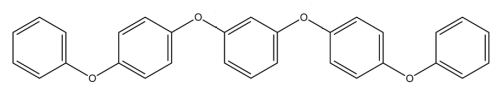

I find it unlikely that deoxit would be able to revert oxides back to metal or anything near that. Most likely all it provides is an oxidation resistant coating on the contact surface.
Large molecular weight fatty acids like oleic acid, do dissolve certain oxides but only at boiling temperatures. It might be that some contact cleaners contain oleic acid in their composition but not for dissolving oxides, just to form a long lasting film on the contacting surfaces. On the other hand, polyphenylethers are well known oily substances that are very stable against oxidation, and if they have sufficiently large molecular weight they have a very low vapor pressure, so they do not evaporate. This is a key in long lasting contact lubrication. Most of deoxit composition is just refined solvents. Some contact cleaner manufacturers indeed use polyphenylethers in their contact cleaners for example MG contact cleaner. An example of a polyphenyl ether is this molecule:
This is very simiar to Santovac-5. It is possible to derive a very large family of compounds from this by bindng specific groups on some of the free corners of the rings, and this may improve the contact preserving action of this base polyphenyl ether. My speculation is that deoxit is the result of a large search for the best derivatives of polyphenylethers that worked the best for preserving the contact conductivity.
