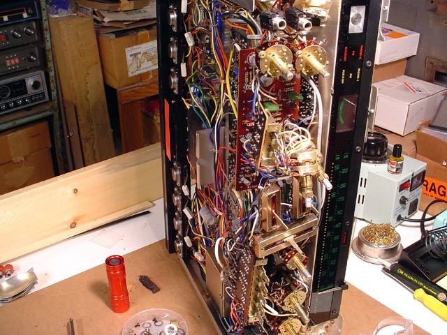

PS - here's one I'm working on right now to give you an idea what one of these things look like if you are really into doing it right.

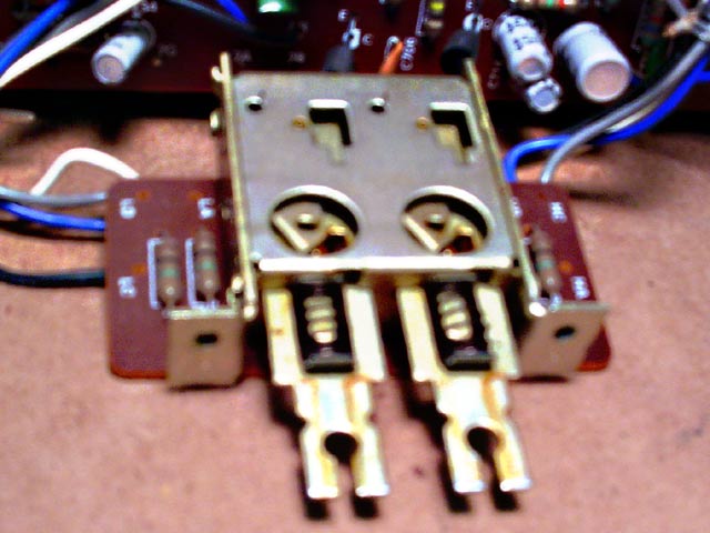

Not to flog a somewhat less than lively horse, but you can actually damage pushbuttons by just hosing them down indiscriminately. Check this out:
This is a fairly typical high end pushbutton. If you'll notice, the front part of the switch (the part you'd be spraying if you were to just poke a straw into the panel) is the mechanical section that has the stuff that makes it go click. All the electrical connections are towards the rear or bottom in most cases. That mechanical section has bearings and pivots that are lubed with heavy grease - which the DeOxit can thin to where it'll drip out and cause premature failure.
So what you're looking at is a three step process. Clean the entire switch with contact/board cleaner/degreaser, DeOx the electrical contacts, then re-lube the mechanical section. If it's working good mechanically, feel free to skip steps one and two - your call, but as long as you're in there ... just saying. I'd also touch up the contacts with Pro Gold. That stuff is magic.
