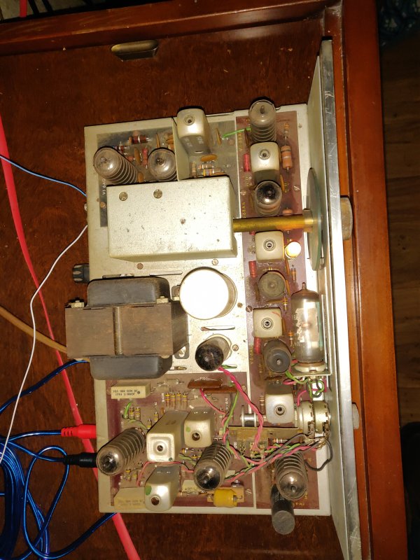

looks like a fm3 to me.if the tag on the back says fm 1then it has been probally converted to stereo with the addition of the multiplex board.
Thank You so much:) the bottom plate says fm1 it has two outputs labeled A and B... there's no other tags
if it was a full conversion your tuning eye tube will be different than the one in the original Fm1 .Also the plastic around the tuning eye tube should have stereo on it .
I popped the top for a quick inside picture
The tuning eye lense has the word stereo on it...

Enjoyed reading through the manual...I see this tuner can be aligned without additional test equipment - using only the magic tuning eye -- brilliant !
Be aware that the FM-1/3 no-instrument alignment procedure assumes that the IF transformers are “new” and are pre-aligned fairly closely to 10.7MHz. Drift over the decades as well as user alignment attempts frequently invalidate this assumption. Net result is that an old FM-1/3 tuner *can* benefit significantly from an instrument alignment as described in the construction/user manual.
It's not the easiest to do though. I restored one with all new caps, resistors, power supply and even custom made PEC's. Someone had tried to align it before I got it. I've tried several times following the alignment directions and it's still not right. I haven't had any luck finding someone to realign it.
You could be experiencing the 10.7MHz issue I noted above. Or, another issue I’ve run across with a couple of FM-1/3s is the failure of the little silver mica caps internal to the IF cans. Depending on failure mode, the result is either a continuous static or crashing noise or inability to peak the signal. The fix for these problems requires surgery on the offending can to remove the bad caps and replace with new caps. This is tedious, delicate, time consuming work. Considering the quality of most FM programming and signal today, this problem if encountered makes restoration of the Dyna tuner either a labor of love or not worthwhile. FWIW, the bad IF/discriminator caps situation is not confined to Dyna tuners.
